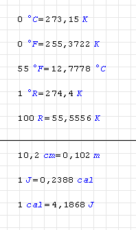

What about the temperature relative scales (Celsius, Fahrenheit)?
Last days I've worked on it and will continue... for now (if we are talking about nonlinear units) any temperature can be converted to Kelvin, but not vice versa.
V. Ochkov recommended me to realize some of his Mathcad worksheets in new version of SMath Studio with Units for tests and here is the first "real" document:
So, it works! See http://twt.mpei.ac.ru/rbtpp/pKw/ to check how it looks like in Mathcad.

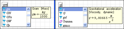

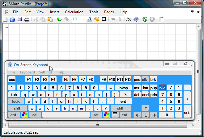

It is not a problem, because Dynamic Assistance feature was implemented. Using Ctrl+[space] you can display a list of available units, variables and functions (Ctrl+[space] will also insert selected item when list is shown).
Please, see the animation below (actions is so slow, because I've used on-screen keyboard... using the real keyboard allows to do all these actions in 2-3 seconds ):

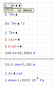

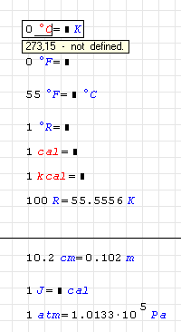

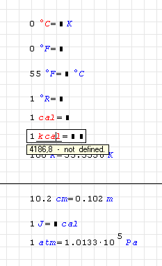

Please could you check about comma and point as decimal separators for Temperature units (Celsius and Fahrenheit). The error "273,15 - not defined" and similar ones are issued when .(period) is used as Decimal symbol.
Not reproduced. Will try to play with regional settings of the system later as well...
It seems that when choosing the appropriate regional settings everything is fine. But when changing the decimal separator via Tools=>Options=>Interface while working on a worksheet, the error appear. Here is the first picture:
Now, changing the decimal separator from comma to point will issue errors. Then replacing the comma with period will fix the things, except on some units - see the picture:
or
The same will happen when the Regional settings are "point", "comma" as decimal and function arguments separators and they were changed via Tools=>Options=>Interface while working on the worksheet
I think It is not such a problematic issue as long as we stick with the same Regional settings. Saving the file and reopening with another setting will fix the things.
