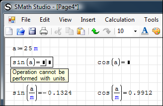

Some intrinsic math function (sin,cos,ln,log...) can be applied on the unit variables. I think this should not be allowed.
Agree. Will fix.
Updated: fixed.

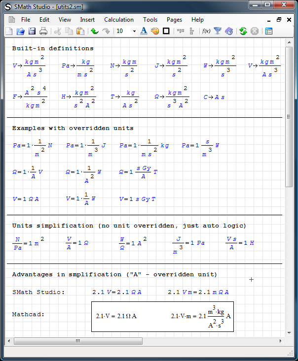

Changes made according to the posts above.
Figure 1: Units simplification dramatically improved!
Figure 2: Error handling improved.
Thanks for testing! New beta will be available soon.

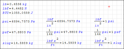

About the definition of pound, lb : the current definition of lb in SMath Studio is 1 lb = 0.4536 kg. ... I would suggest adding the pound-force 'lbf' in SMath Studio, with 1 lbf = 4.44822161526 N.
Including the pound-force, as I suggest, will allow us, hydraulic engineers in the U.S., to use the commonly-used unit of pounds per square inch (psi = 1 lbf/in^2) for pressure, which currently I cannot properly define. If you decide to include 'psi' in your collection of units, use 1 psi = 6894.75729317 Pa. I also use the psf = pound-per-square-foot, 1 psf = (1/144) psi = 47.8802589803 Pa.
By the way, the unit of mass in the English System ( E.S. ) is the 'slug', 1 slug = ( 1 lbf )/(1 ft/s^2). The "slug" should be included in the units of mass in SMath Studio also. 1 slug = 14.5939029372 kg.
Also, the BTU, or Btu, (British Thermal Unit) should be included in the units of energy, since is still commonly found in HVAC applications. 1 BTU (or Btu) = 1055.05585262 J.
All units you've mentioned added to the built-in list:
