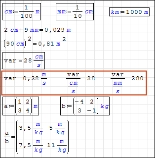

Good news for people, who have requested implementation of Units to the SMath Studio. Here is screenshot of what I have for today:

Just few notes.
SMath Studio will support Units inside matrix/vector/array even if items will be presented with different units.
Even if user will not know about how to insert Units (using ampersand symbol on start), Dynamic Assistance will show all available units as well as variables and functions in drop-down list.
Regards.

#11 Posted: 2/27/2010 6:17:08 PM
2,343 likes in 4,042 posts.
Sure.
For now, I cannot find the way more convenient then MathSoft done. My plan was to make first release of Units without an ability for user to operate with result (results will be always presented with base units)... it depends on my time availability. Hope you'll understand it.
Regards.
#12 Posted: 2/27/2010 7:16:08 PM
I understand Andrey, of course . You are right, Mathcad has quite good unit conversion features. As far sa I am concerned, it would be quite enough if you could implement the ability to, say, devide the variables with the appropriate units and to obtain the numerical value:
a:=1m
b:=a/cm
b=100
If not, never mind - some other time .
Reards,
#13 Posted: 2/27/2010 11:47:45 PM
Yeah, it will work.

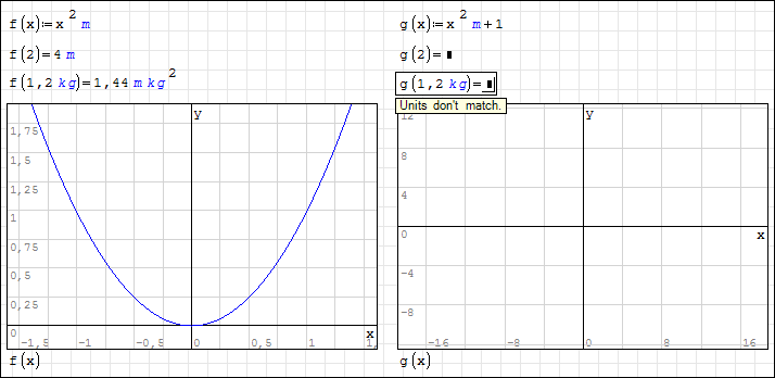

#14 Posted: 2/28/2010 11:06:22 AM
Thanks Andrey
It is very good. Also, I am convinced that everyone will agree that units in different color is much more acceptable.
I think that we can assume that there would be no problem to have unit variables as function arguments. Moreover, I hope that plotting with them will also be possible. On the basis of your screenshots I suppose that we could manage that, couldn't we?
#15 Posted: 2/28/2010 2:14:08 PM
Do you mean this? By the way, I don't know why, but Mathcad can plot the second graph...
#16 Posted: 2/28/2010 4:13:23 PM
Yes, this is strange. It seems that this is due to Mathcad feature to mix units and numbers in symbolic calculation, when you use g(1.2kg)-> simbolicaly you will get the result with units in it (numericaly will be wrong). Afterwards, when you want to plot the function, Mathcad converts all the units in base units and, after that, gives them unity value (one) and you can plot this. BTW, working with units in Mathcad can be sometimes confusing because of this and proone to errors. One must be careful about it and I made many mistakes considering this.
For instance:
f(x):=x^2*m+10 will convert into f(x)->x^2*1+10
g(x):=x^2*cm+10 will convert into g(x)->x^2*0.01+10
This might be questinable because you can plot x versus y even in this way (with the expression with units which do not match - expresion with inconsistent units)??? Therefore I asked about divison by the desired unit because of the x,y axis on plots or other variables. This way you can have the numerical (dimensionless) values in the desired units on plots.
PS. From my experience with Mathcad, working with units is quite safe when this includes basic algebraic operators. If using some special functions (numerical...), plotting etc. which include units, extracare is needed. The safest way is to work without units first, and put them afterwards.

Terrific job on the units so far! I'm looking forward to using it. The only thing that seems to be missing is the extra input field for the output value (which isn't actually a unit field in mathcad, it can contain anything. Apparently mathcad just does a symbolic division and outputs that before the field. Very effective though).
As for the graphs. Seems logical that the second one wouldn't work. The fact that is does is probably a testament to the horrible way mathcad seems to handle units in graphs. All you want it to do is input your range in the proper units and have it output the axis values in the units of your choice. But that never worked and it always had weird side effects. (Disclaimer: I never used any mathcad beyond version 9 (=2000) )

#18 Posted: 3/3/2010 12:38:08 AM
Edwin, hello! Do you talk about this:
P.S.: omorr, I did it!
