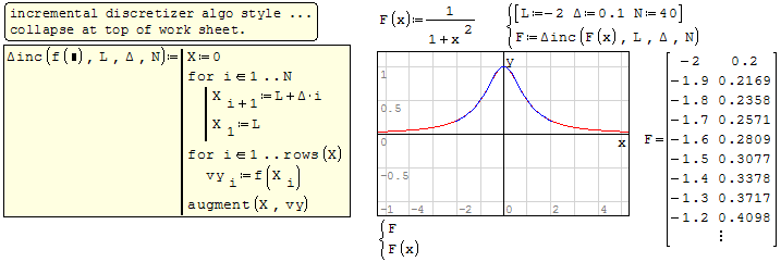

Just opened Ber7 document and completed to export the multiple data sets.
You can tabulate as well p2, p3, ... p6 then make a unique export table.
The meshed pivot is an exceptional tool, save it.

... super discretizer, algo style.
#12 Posted: 1/19/2021 9:08:42 PM

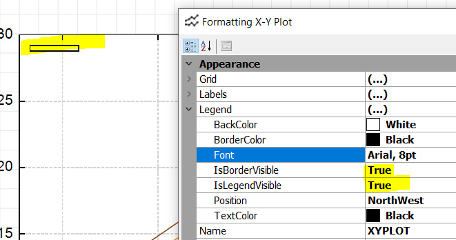

Really helpful. Is there a reason that a legend cannot be created on the plots (X-Y Plot) that are individual colors? I realize you used the built in graph and I updated my snippet sheet with the X-Y PlotCapture.PNG
NEVERMIND ... It'S under TRACES, not LEGEND
X_Y plot does not recognize the multiple linterp, thus plots one trace only.
Alternately, you can add some sort of legend on the QuickPlot.

Ber7 did the 2 var collection in nested vector form,
my last version is table style, much more convivial as I'm used to do.
Units are just a pen in the ass[hole].
A good way is to work units-less, then append silent units.

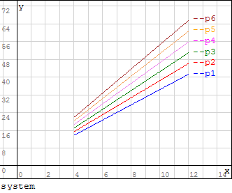

Graph with legend
Ps.sm (7.12 KiB) downloaded 1138 time(s).

Thank you guys. I should have just deleted the question when I figured out the legend issue in lieu of answering myself. As mentioned above, it was under TRACES, not LEGEND, in the X-Y Plot
