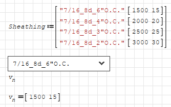

Hello all,
I'm a new member of SMath. Im wondering if it is possible to use combobox to return multiple values from a matrix. Ive attached an image below as an example. If I select 7/16"_8d_6" O.C. I want to have both the 1500 and 15 value return without having to make multiple comboboxes.
Thanks!

Use a nested matrix.
multicombo.sm (4.18 KiB) downloaded 1365 time(s).

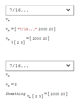

You can also use ranged indices to pick any column you need listed in the order you prefer, without any change in the input matrix.
This is an example using either the item row or the item index

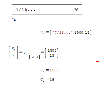

One more question if you don't mind. Is is possible to set the results to a different variable? For example. I want the 1500 value to be "vn" and the 15 value to be "Ga". This way the equations will make more sense if someone is reviewing them.
Thanks!

Like this?

Yes that is exactly it.
