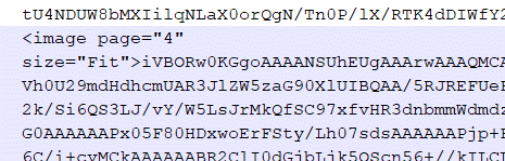

I did not know that several background images can be inserted. Actually, I do not know how to do it either. But as workaround you can edit the sm file for correct the position of the image on page 3.

Thank you for this way around. First time I venture into a sm file. I will give it a try.
As for how to do it, just select "Background..." in the "Insert" menu. You will see the background setting window.
As I mention in the post, part of that UI is not obvious. It is hard to tell if you have already selected a "Current page" background. Also the default setting seem to reset itself each time you quit the window. The expected behavior would be to reflect the setting of the current page or the whole document.
#5 Posted: 9/14/2018 9:20:13 AM
Editing the file worked first try. That is great :-) The sm format is pretty simple, nice to see that.

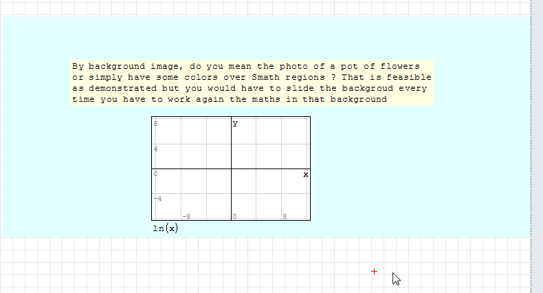

Simply, capture image from what's on screen from any source [web page, Smath document ...]
Paste the image in the Smath document you want.
You can PrintScreen, paste in Paint, select, copy/paste in Smath.
My preferred capture tool is WinGrab [freeware], once selected/cropped, "Save as" [*.PNG ...]
... save in a dedicated folder in C:\ Snippets [Snippets is typical in my system]
You can recall any image you have saved, paste in Smath, of original size high quality.

This peanut demo is 2.65 kB. You can have as many regions as you wish,
of any colors out of 1677216 possible colors. The background is OK
by the Print Preview, thus will be saved on virtual *.PDF printer.
This background region is not an imported image, neither an image
created by Smath. Thus, every time you save and at the opening of
the document, Smath complains it can find ... because it is not
really created ... just an incomplete fake. So, on the complain
just click OK to stop Smath suffering.

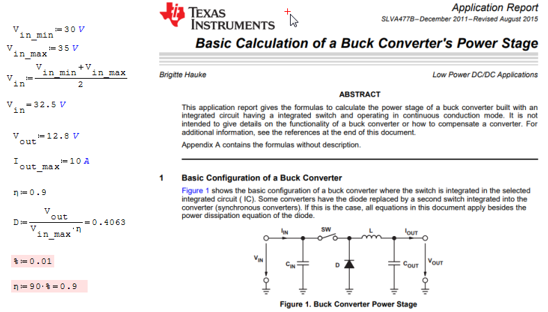

Andrey, this tweak just added a whole new horizon of uses of SMath for me, thank you!!!!!
Fresh example of use to annotate with image region (this is neat!)
