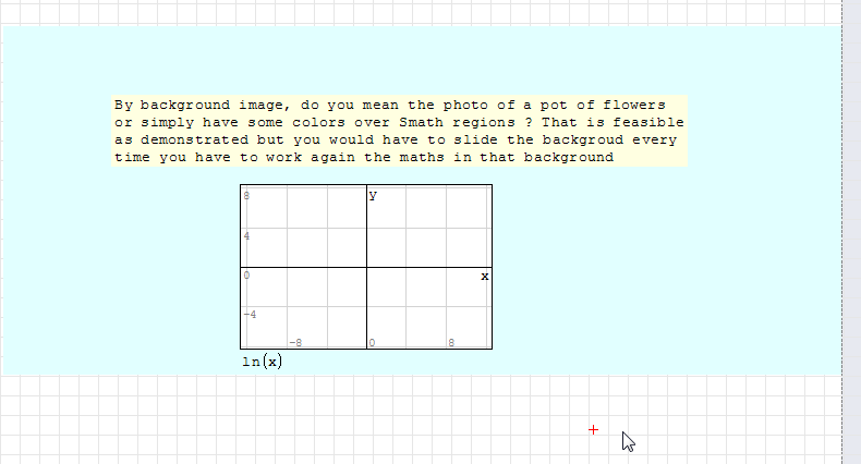

This peanut demo is 2.65 kB. You can have as many regions as you wish,
of any colors out of 1677216 possible colors. The background is OK
by the Print Preview, thus will be saved on virtual *.PDF printer.
This background region is not an imported image, neither an image
created by Smath. Thus, every time you save and at the opening of
the document, Smath complains it can find ... because it is not
really created ... just an incomplete fake. So, on the complain
just click OK to stop Smath suffering.
Jean [Drummondville]
