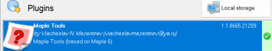

There are several reasons. Firstly, this Maple plugin is made by only one person and he does not have enough time to do anything extra. Secondly, old versions of Maple could be divided into console and window parts. The console part can be placed entirely in the plugin, so the function is immediately available after its installation. Thirdly, the syntax and capabilities of the maple engine change and it takes a lot of time to debug the interaction of the two programs.
Yes, theoretically it is quite possible to do this, but from the practical side it is inconvenient. Maxima plugin went this way, and started with the maple version.
Now inside the Maple plugin there is a license file, so you can use it, but someday it will end. Due to licensing issues, there is no desire to make any improvements, it is better to spend time on free software.

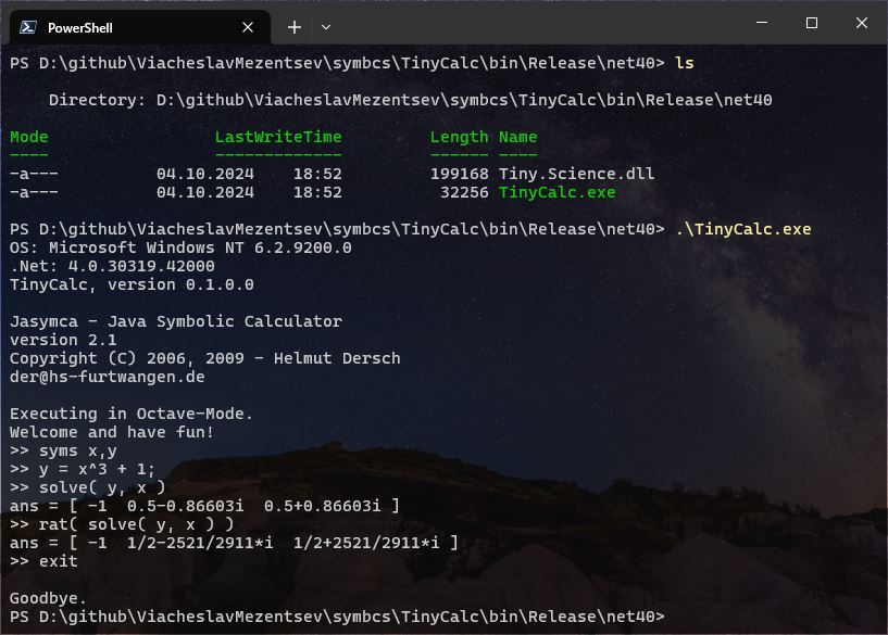

I have my own development for this case, if necessary, I can connect my own port for symbolic engine based on Jasymca.

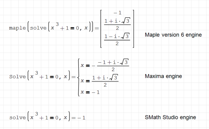

Oh, so we see that SMath own engine is very week...though the problems was pure numeric...
#12 Posted: 10/4/2024 9:39:50 PM
1,553 likes in 1,864 posts.
As for your example, you have to be honest. SMath Studio writes in the documentation what this function does. It is neither good nor bad. It does its job.
