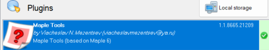

I see that currently version 6 of Maple (released in year 20000, so 24/25 years ago) is used:
I am wondering if is not possible to use a newer version of Maple engine in Smath?

Theoretically I think it is quite possible. But in this case, Maple must be installed in the system separately. The maple plugin must be updated to be able to work with new versions.

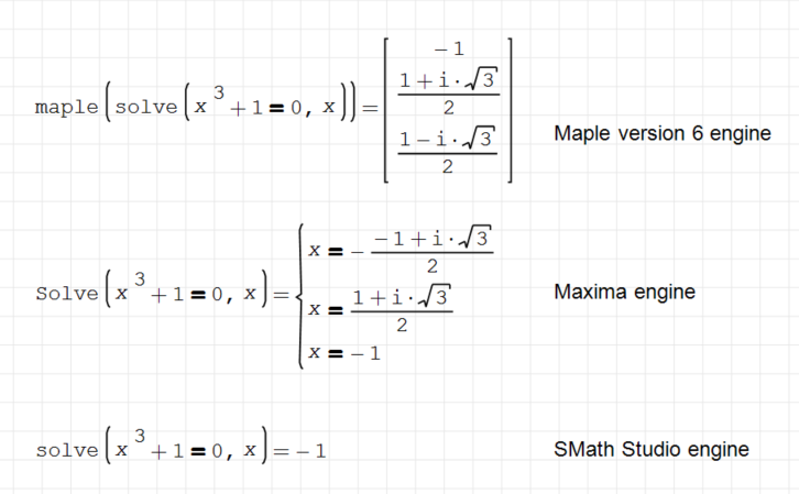

But Smath Studio without additional engines like maple engine or maxima or any other powerful math engine...Smath seems to have only numeric capabilities (probably these numeric calculation capabilities strong enough up to a certain point, right?), and When it comes to symbolic calculation then Smath Studio stuck, is lost, without working together with these additional engines. That's I asked what will happen when will not be aymore possible to use maple/maxima engine in Smath studio. Also, with the passage of time without improvements even to these engine used by Smath (maple, maxima, or Smath studio own engine), Smath will become weak, when the need for computing power/calculation will increase.

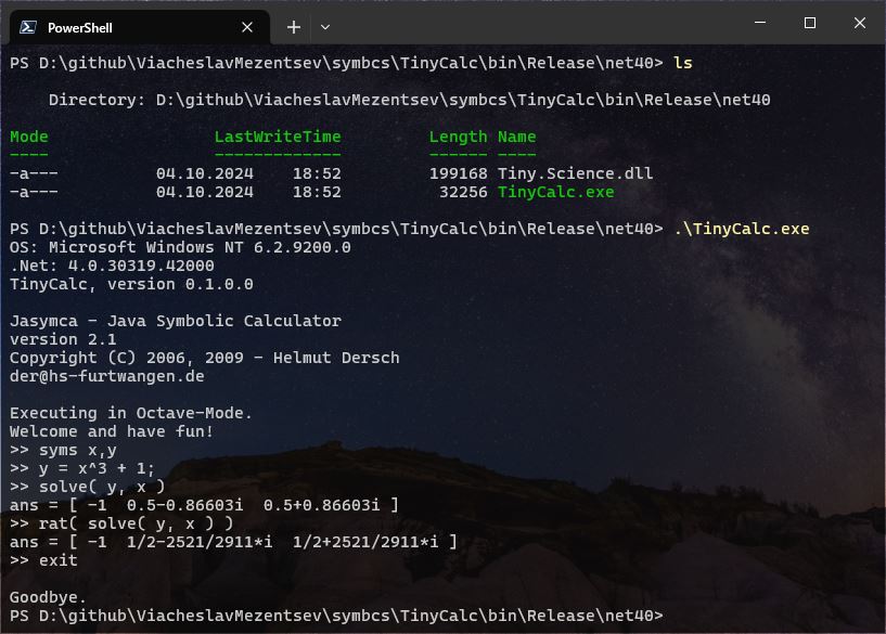

I have my own development for this case, if necessary, I can connect my own port for symbolic engine based on Jasymca.

Oh, so we see that SMath own engine is very week...though the problems was pure numeric...

As for your example, you have to be honest. SMath Studio writes in the documentation what this function does. It is neither good nor bad. It does its job.
