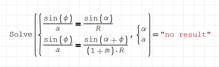

Thanks Jean,
Both a and alpha are unknows.
the result of a and alpha are still includes these unknows.
Only φ, R and m are knowns and can be used in the results.

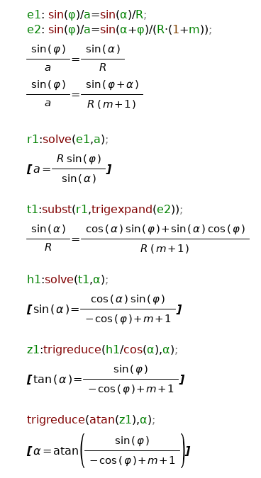

Symbolic solver of maxima is not that capable.
As far as I know of course, maybe there is a simpler way.
But this statement was what I had read about it.
You have to use some substitutions for that solutions.
And some extra division, arc functions, visa versa.
Here is α solved symbolically in wxMaxima.
Same method can be applicable for variable a.
untitled.wxmx.zip (1.6 KiB) downloaded 399 time(s).

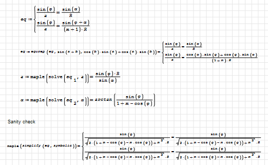

Is Maple plugin in Smath able to get symbolic results as Maxima does, but more easily?
#7 Posted: 2/22/2022 11:55:34 AM
WroteIs Maple plugin in Smath able to get symbolic results as Maxima does, but more easily?
Maple is easier to use, that is a fact.
And sometimes it gives better results.
But Maxima can surpass Maple at certain aspects.
Use what suits your needs most.
In the example below, I solved your function with Maple.
Though it gives the results correct, result matrix is cripled.
Copying and changing last bits of result ";2;1)" to ";2;2)" will correct the result.
";" may differ to "," according to your arguments separator.
Worksheet1.sm (15.97 KiB) downloaded 1349 time(s).

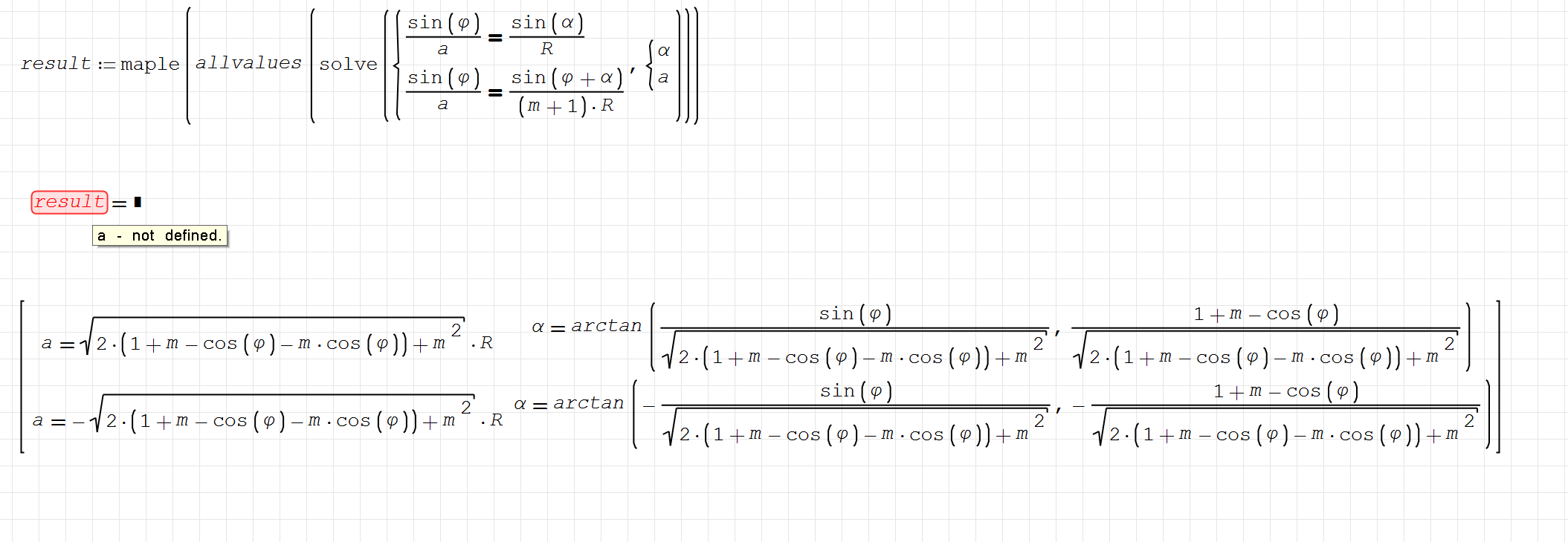

Hi overload,
When I open you sm I get this error
#9 Posted: 4/16/2022 9:57:28 AM
#10 Posted: 4/16/2022 12:26:22 PM
WroteWroteWroteIs Maple plugin in Smath able to get symbolic results as Maxima does, but more
Hi overload,
appears in red, because the evaluation must be symbolic.
select the "result" variable, press the right button and in the type of evaluation select symbolic and that's it.
I hope I have served you, greetings

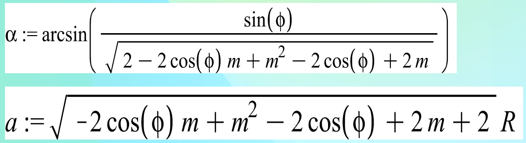

Hi. Another way, applying trigonometric identities.
solve_trig.sm (12.03 KiB) downloaded 1292 time(s).

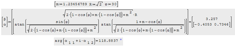

#12 Posted: 4/17/2022 8:32:35 AM
WroteThanks Jean,
Both beta and alpha are unknown.
the result of beta and alpha still include these unknowns.
Onlyφ, R and m are known and can be used in the results.
... to be used as productive.
Your system is baby stuff, example 2 advanced.
I leave it there, not knowing more about your end demand.
Simply a solved formula representation ???
Comment or ignore ... Jean.
Solve ADVANCED Productive.sm (22.64 KiB) downloaded 1321 time(s).

Wroteselect the "result" variable, press the right button and in the type of evaluation select symbolic and that's it.
Addition to churichuro's reply, use this simple function to correct maple plugin result matrices.
maplecorrect.sm (26.79 KiB) downloaded 1906 time(s).
