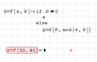

I'm not sure, but I think I might have found a bug:
I remember this used to work before. Am I doing something wrong?

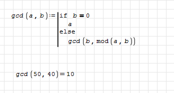

error
You need to use line operator in function definition.
Edit: A note about recursion. I do believe that Andrey limited the recursion depth that can take place. I think its somewhere around 50.

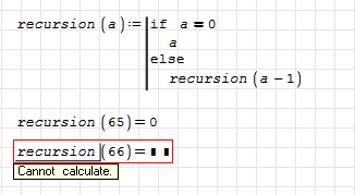

Example of recursion limit.
#4 Posted: 11/30/2022 2:11:53 PM
1,139 likes in 1,805 posts.
Hi. Every CAS should have a recursion limit. The point would be to be able to control it, like in Mathematica: https://reference.wolfram.com/language/ref/$RecursionLimit.html
error
Thanks!! How did I forget that. heh.

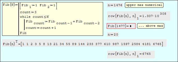

The Mathematica 4.0 Fibonacci recursion has Smath companion algo style.
#7 Posted: 11/30/2022 9:57:13 PM
That is not an example of recursion, that is an iterative method. Try googling something like "iterative vs recursive Fibonacci".

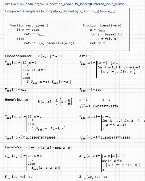

Either.
recursive_versus_iterative.sm (40.78 KiB) downloaded 1674 time(s).
