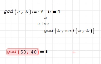

I'm not sure, but I think I might have found a bug:
I remember this used to work before. Am I doing something wrong?
#2 Опубликовано: 30.11.2022 09:40:43
Arie
Arie
error

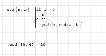

You need to use line operator in function definition.

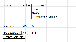

Edit: A note about recursion. I do believe that Andrey limited the recursion depth that can take place. I think its somewhere around 50.
sergio 30.11.2022 11:16:00
#3 Опубликовано: 30.11.2022 09:48:02
Arie
Arie
Example of recursion limit.
error
Thanks!! How did I forget that. heh.

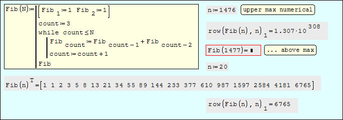

#6 Опубликовано: 30.11.2022 18:10:45
The Mathematica 4.0 Fibonacci recursion has Smath companion algo style.

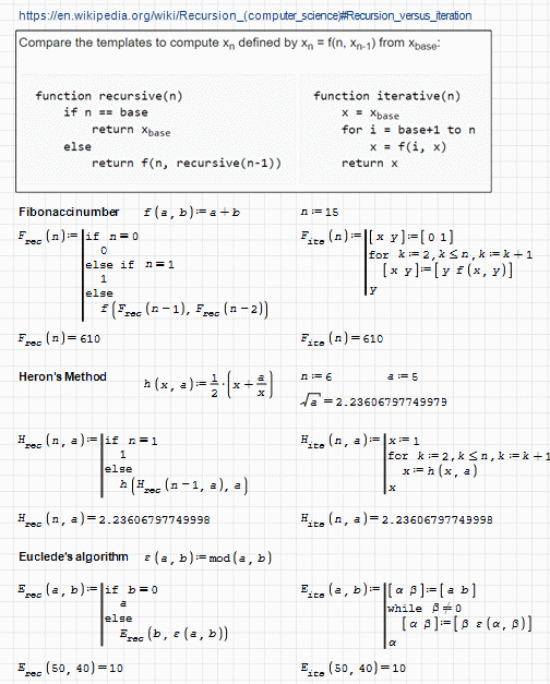

#7 Опубликовано: 30.11.2022 21:57:13
That is not an example of recursion, that is an iterative method. Try googling something like "iterative vs recursive Fibonacci".

#9 Опубликовано: 01.12.2022 22:09:52
Maths Sqrt(x) Heron DEMO.sm (11,66 КиБ) скачан 1607 раз(а).
Either.
recursive_versus_iterative.sm (40,78 КиБ) скачан 1674 раз(а).
