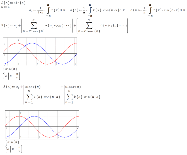

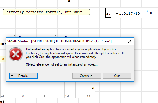

Some times it crashes when trying to evaluate some variables.
ISERROR QUESTION MARK_B (1).sm (18.72 KiB) downloaded 1467 time(s).
ISERROR QUESTION MARK_Clean.sm (10.4 KiB) downloaded 1475 time(s).

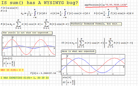

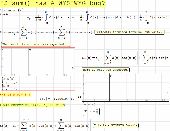

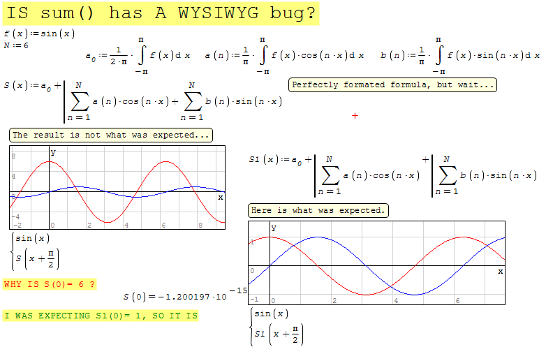

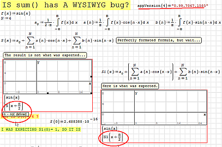

This problem with summation will come up here and there. It would be enough to put the summation terms inside a single line environment. This behaviour is present in SMath for quite a while. This is easy to forget, but it should not have crashed in those cases. The problem is how to remember this issue and overcome situations like this one.
WroteThank you Alvaro, you are right
Can't be more right ! Now you understand why I never updated.
How do you know if it is simply a beta version bug ?

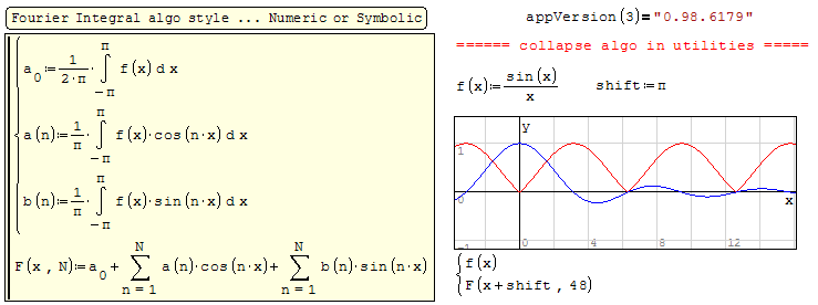

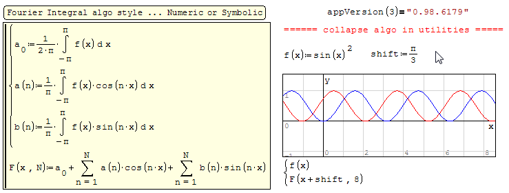

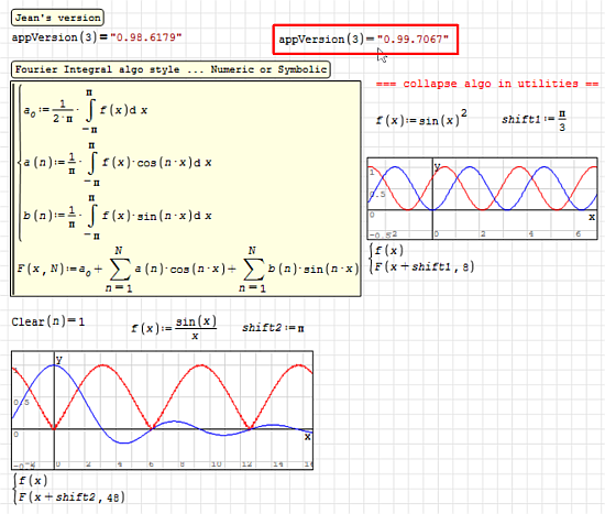

Try this Fourier-algo style.
Fourier Integral Algo Style.sm (7.66 KiB) downloaded 1410 time(s).
But if included in line program, works for ever. My fft(,) ifft(,) work since day 1 [2015].
The free style Σ is not recognized by Smath kernel.
I have more than fft(,) ifft(,) like Simplex lot more involved works great within line.
I wish to read "Thanks Jean, doctored".

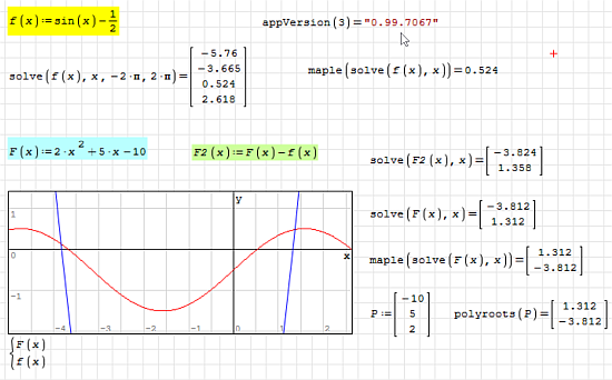

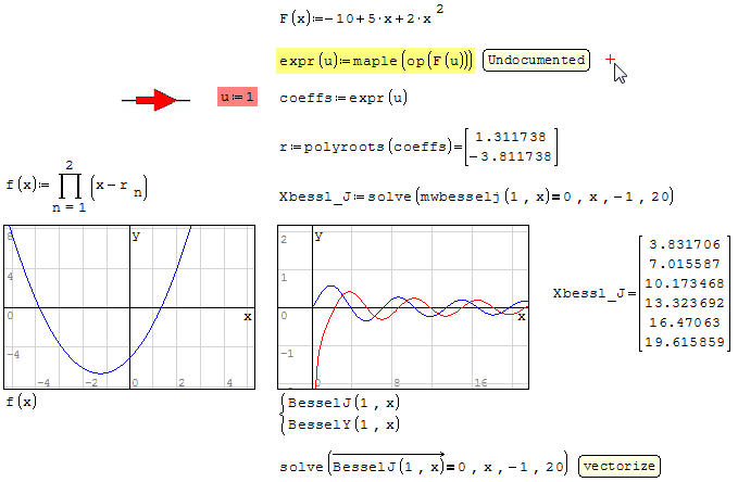

The attached sm file also crashes some times when inputs to Polyroots, solve, maple(solve)
are changed or adjusted.
Roots_Ex1.sm (16.06 KiB) downloaded 1389 time(s).
I will try more variations and post if there is any crash.
Thank you you Radovan.
WroteThe attached sm file also crashes some times when inputs to Polyroots, solve, maple(solve)
That shouldn't happen, but maybe on latest beta.
1. Polynomials have unique Lagrange format [lot many books are wrong].
2. maple(op(F(u))) will save you manual steps and possible typo errors.
Maths eigenAll Companion.sm (62.14 KiB) downloaded 1378 time(s).

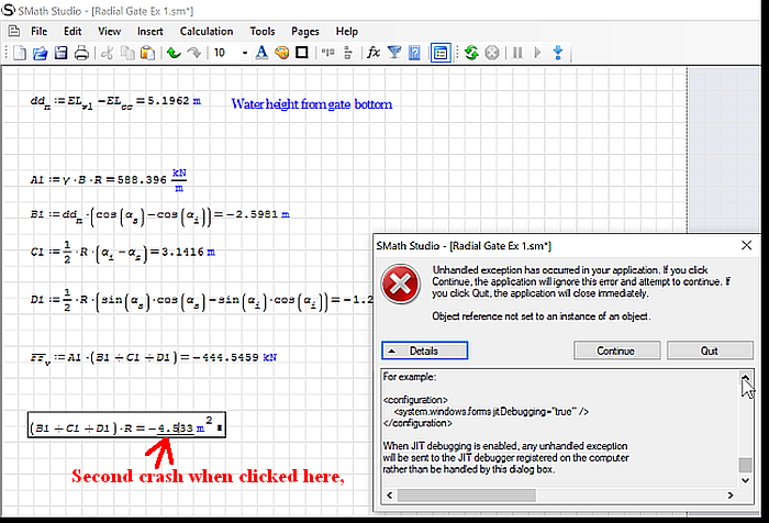

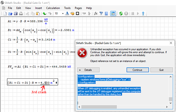

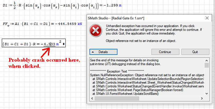

Even after a Clean Re-installation, crashes continued to occur on and off.
Attached sm file crashed when I was doing some changes to either default units,
or copying etc. (I'm not sure). Note where I clicked.
Radial Gate Ex 1.sm (194.77 KiB) downloaded 1349 time(s).
WroteEven after a Clean Re-installation, crashes continued to occur on and off.

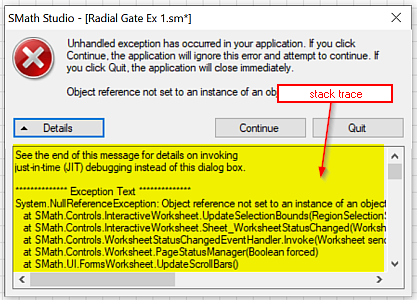

Second crash. BTW how do I create stack traces and copy?
Radial Gate Ex 1.sm (195.59 KiB) downloaded 1399 time(s).
WroteBTW how do I create stack traces and copy?
Simply copy the text from the error window
You can paste in the following BBcodes if it is too long
[spoiler]my text goes here[/spoiler]
or
[code=markup]my text goes here[/code]
Third crash occurred, and the stack traces (in MS Word) attached.
Radial Gate Ex 1.sm (195.59 KiB) downloaded 1340 time(s).
7067 3rd Crash-Stack Traces.docx (18.08 KiB) downloaded 852 time(s).
