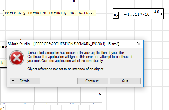

Attached sm file which appeared recently in the forum works in 7030 (stable), but throws errors in 7067 (Beta).
Some times it crashes when trying to evaluate some variables.
ISERROR QUESTION MARK_B (1).sm (18.72 KiB) downloaded 1496 time(s).

Confirmed,
Sometimes crashed (red cross over the screen) and sometimes didn't.

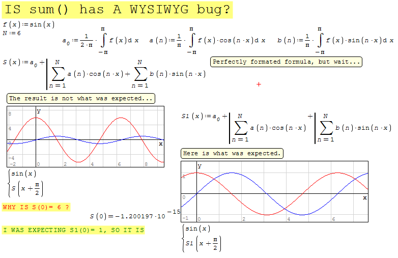

Hi. I don't see a bug here, but some kind of issue handling n. About the WYSIWYG notation, it's well know this kind of difficulties not only in SMath, but in mathcad, maple and mathematica too. About the issue with n it must to be solved using Clear, because n isn't local in the sum.

Thank you Alvaro, you are right
This problem with summation will come up here and there. It would be enough to put the summation terms inside a single line environment. This behaviour is present in SMath for quite a while. This is easy to forget, but it should not have crashed in those cases. The problem is how to remember this issue and overcome situations like this one.

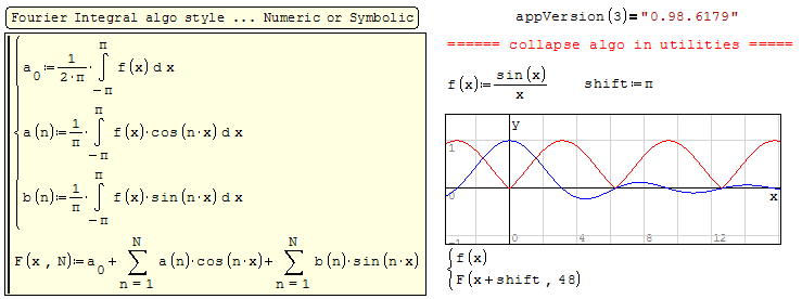

Try this Fourier-algo style.
Fourier Integral Algo Style.sm (7.66 KiB) downloaded 1447 time(s).
NDTM Amarasekera 5/11/2019 1:15:00 PM

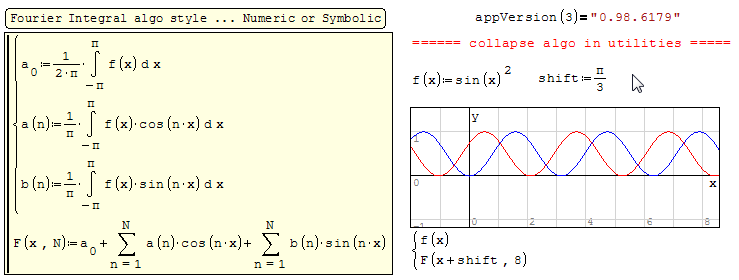

#6 Posted: 5/11/2019 12:30:37 PM
Leave default integral acc 100, only 'N'
Rejects SQRT(x) but takes SQRT|(x)|
Try more ... let us know about your version ... Jean

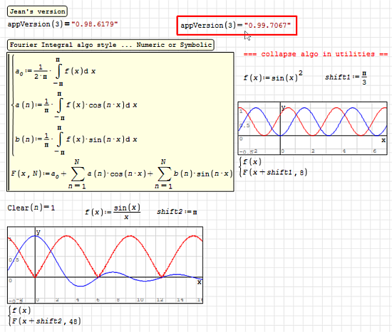

#7 Posted: 5/11/2019 12:55:36 PM
Generally, the range Σ free style works at time of creation but fails back on new session.
But if included in line program, works for ever. My fft(,) ifft(,) work since day 1 [2015].
The free style Σ is not recognized by Smath kernel.
I have more than fft(,) ifft(,) like Simplex lot more involved works great within line.
I wish to read "Thanks Jean, doctored".

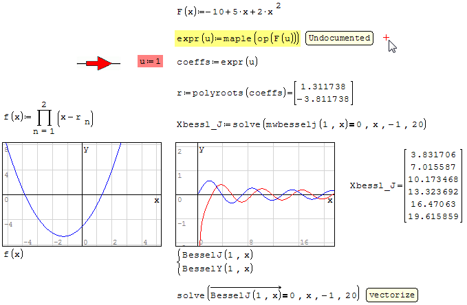

The attached sm file also crashes some times when inputs to Polyroots, solve, maple(solve)
are changed or adjusted.
Roots_Ex1.sm (16.06 KiB) downloaded 1417 time(s).
#10 Posted: 5/12/2019 4:44:58 AM
Tried but it did not crash.
#11 Posted: 5/12/2019 6:30:00 AM

#12 Posted: 5/12/2019 10:37:18 AM
That shouldn't happen, but maybe on latest beta.
1. Polynomials have unique Lagrange format [lot many books are wrong].
2. maple(op(F(u))) will save you manual steps and possible typo errors.
Maths eigenAll Companion.sm (62.14 KiB) downloaded 1410 time(s).

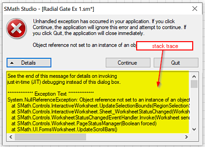

#16 Posted: 5/13/2019 6:54:36 AM
Still not able to reproduce but at least we have an hint.
BTW how do I create stack traces and copy?
Simply copy the text from the error window
You can paste in the following BBcodes if it is too long
[spoiler]my text goes here[/spoiler]
or
[code=markup]my text goes here[/code]
