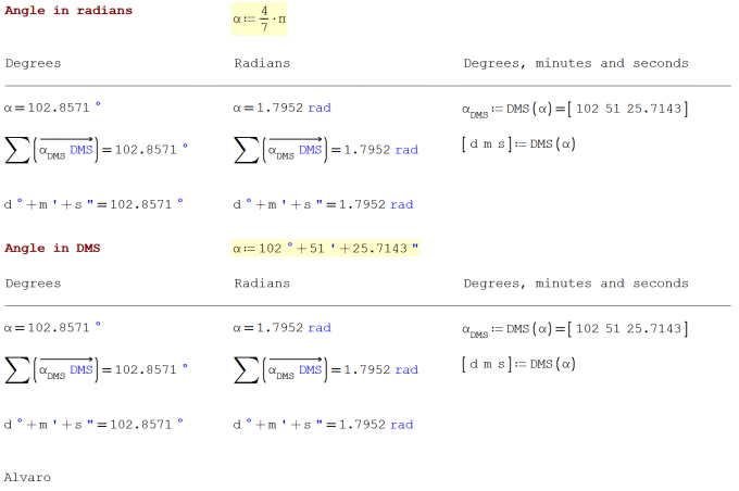

#5 Posted: 2/23/2019 12:16:22 PM
1,138 likes in 1,805 posts.
Hi. Here, my workaround.
DMS.sm (17.67 KiB) downloaded 1195 time(s).
frapuano 2/23/2019 12:28:00 PM, sergio 2/23/2019 6:26:00 PM

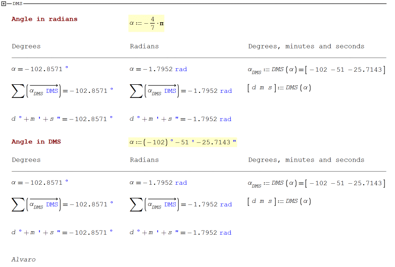

Hmmm... The separate units use is interesting. I am so inexperienced with SMath I can't figure out how to enter the summation portion.
I think I will need to leave the negative angle input as [ -d -m -s ] with this approach. Would you agree?

#8 Posted: 2/23/2019 2:06:06 PM
Hi. Try this as general rule for SMath sintaxis:
Guess yes:
