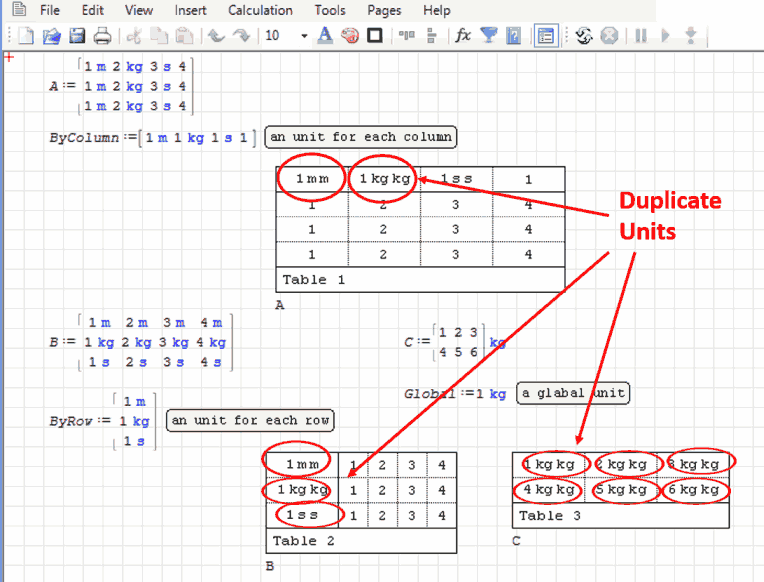

Why units are duplicate in Table Region?
units (1).sm (21.03 KiB) downloaded 1721 time(s).
#62 Posted: 12/17/2017 8:39:26 AM
It's a bug
thank you for reporting, I'll fix it ASAP.

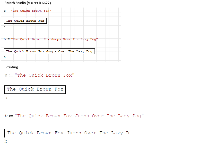

#68 Posted: 4/2/2018 12:48:15 PM
Thanks for the work with this plugin, it has proven to be a very useful and much needed feature.
I am however having one small issue. My table displays fine within SMath, but when I print, depending on how many characters there are, the table cuts off.
This is only when I print.
Is there something in the settings I am missing?
All settings are default in the attached example.
Thank you!

#69 Posted: 4/3/2018 6:11:41 AM
WroteHello,
Thank you!
Confirmed. Unfortunately string scaling is driven internally by the .NET framework (here the ssue is how letters are spaced), so there aren't easy fixes. I'll think if I can do something however, thank you for reporting.
#70 Posted: 4/3/2018 7:39:04 AM
I have seen that by adding some final spaces the string becomes completely visible. It is not a solution but can be used in some cases.
Even the formatted label has a similar behavior but in that case the string wraps.
#71 Posted: 4/5/2018 12:27:51 PM
PompelmoTell - Yes, I did figure this "fix" out as well. Depending on the length of the original string, more spaces need to be added to the end. Not the best of solutions given that I am working with large amounts of data of varying length.
What is confusing to me, is that if the string is longer, it will print more of it, but also remove more characters at the end. if the string is shorter, it removes less characters but the end result is a shorter string than the previously mentioned. There doesn't seem to be be a fixed length when printing and it depends on the original length.
Lets hope the champion Davide Carpi has a solution to this!

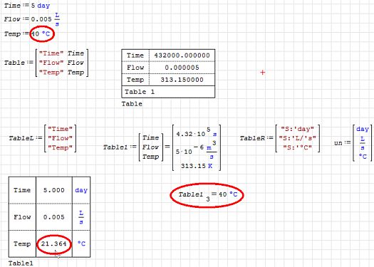

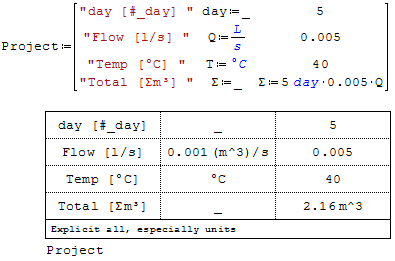

#73 Posted: 6/25/2018 11:57:08 AM
I observe a peculiar behavior when "Temp" is changed from 20 Celsius to, say, 40 Celsius.
See how the table value responds when input "Temp" is changed to 40 Celsius.
Where have I gone wrong? Apparently, this happens only with Temp units (needs further checks).
Units_Table_r2 (1).sm (17.27 KiB) downloaded 1583 time(s).

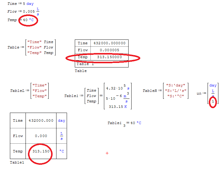

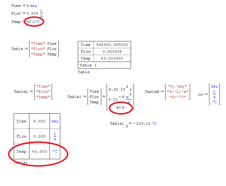

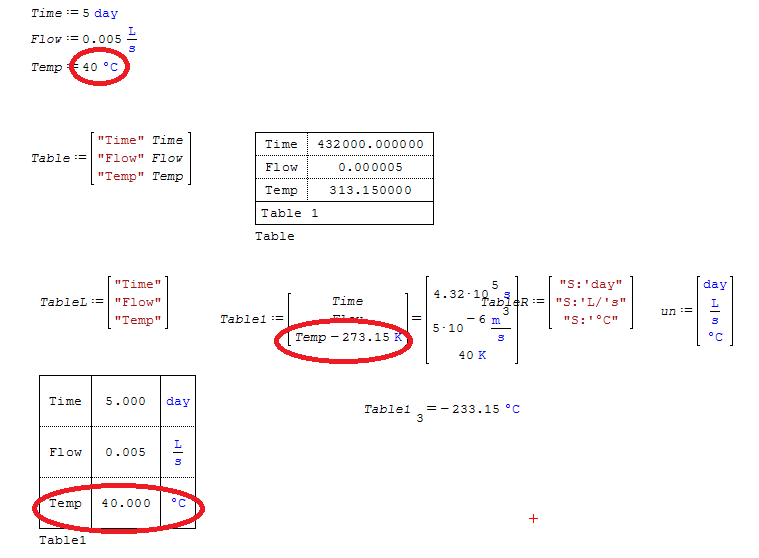

#74 Posted: 6/25/2018 12:54:50 PM
This seems to be related to offset between Celsius and Kelvin.
I can produce the correct output (with incorrect input) by changing units of Temp to Δ°C OR by changing value in Table1 to Temp-273.15K.
Note that by setting the units in the un column to 1 from °C, the temperature is shown in Kelvin as the first table in the .sm.
Somehow the conversion from K to °C is not being performed properly within table region.

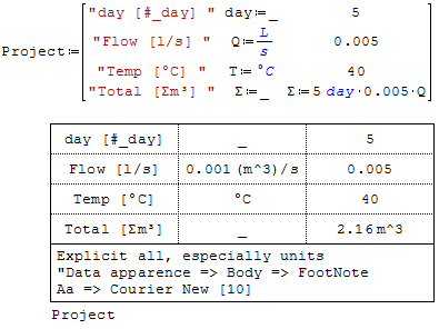

#75 Posted: 6/25/2018 7:01:35 PM
WroteWhere have I gone wrong ?
Not easy to get Table that makes sense ... kind of pest !
Table Region [Project].sm (7.85 KiB) downloaded 1452 time(s).

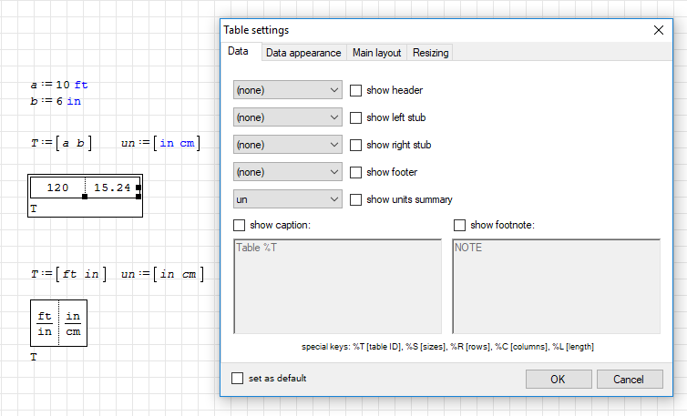

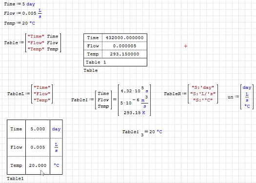

#76 Posted: 6/25/2018 7:19:12 PM
#77 Posted: 6/25/2018 7:42:28 PM
alyles,
The way the unit summary matrix works is that it actually does a unit conversion as seen in the image below.
the "in" unit shown in the un matrix is converted to the default unit in the same way the "a" and "b" variables are. Then the un matrix divides the T matrix to cancel out the units and display the values in the units chosen in the un matrix.
In the image shown below, the 6in are converted to 0.5ft when placed into the table, then the cm unit in the un matrix is converted to 0.0328ft and divides the 0.5ft value, making it 15.24 as shown.
Note that the unit summary matrix is not being displayed. They will not display as entered into the unit summary matrix because they are converted to the default unit as explained prior.
If you want the units to display, you will need to add a right stub with the units as "S:'unit" as shown before.
It would appear that there is something wrong with the conversion being made for temperature.

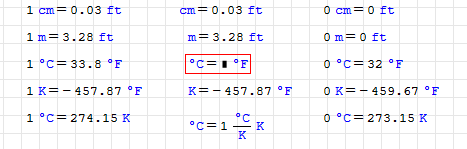

#78 Posted: 6/25/2018 8:33:04 PM
ndtma,
To answer your question as to where you went wrong. Well, you didn't go wrong. The issue, I believe (I may be wrong), is that the way the "unit summary" matrix is designed to work, it assumes that the conversion can be made with a multiplying factor, but since the temperature scales do not share the same zero, there is no factor to multiply for the conversion in some cases.
I think what it comes down to is a matter of how the conversions actually happen. This goes for any portion of Smath Studio. See below. From Celsius to Fahrenheit, Smath won't make the conversion unless there is an actual number in front of it. Similarly, from Celsius to Kelvin, without the number in front of the unit the conversion is broken.
From Kelvin to Fahrenheit oddly enough, the conversion seems to work. I'm not sure how these are set up within Smath.. but there you have it. Food for thought I guess.
