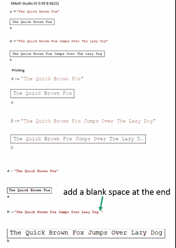

adding a blank space at the end of the sentence solves the problem

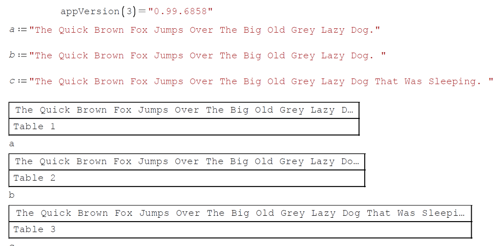

Here is an example of what I mean. "a" has no space, while both "b" and "c" have each one space. As you can see "b" has 3 missing characters counting the blank space on the end, while "c" has 4 missing characters.

So... I did some testing and here are the results.
String Length....Spaces Needed at end to display full string
1-12...............0
13-46..............1
47-70..............2
71-94..............3
Every +24.........n+1
If printing portrait mode, default font size you wont need more than 3 spaces.
Landscape mode will need 5 with default font size.

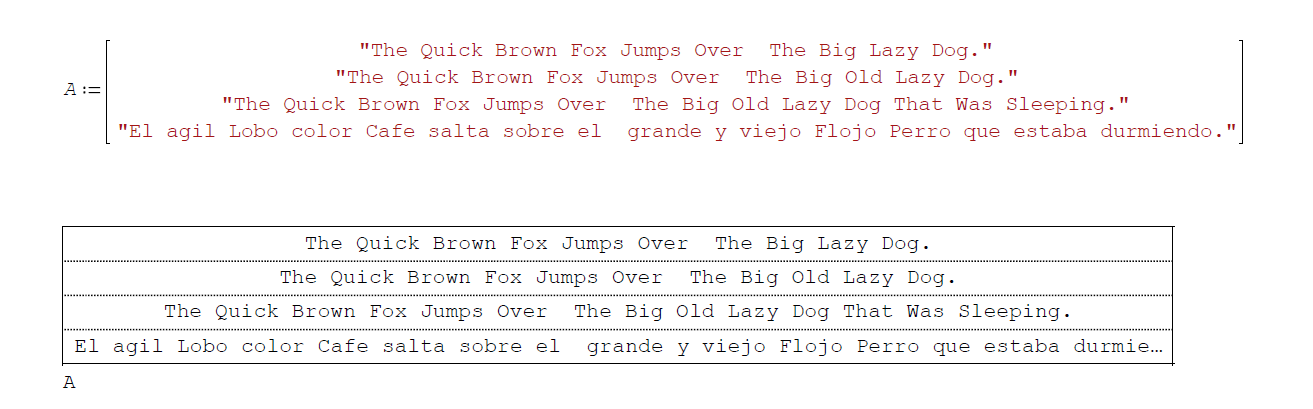

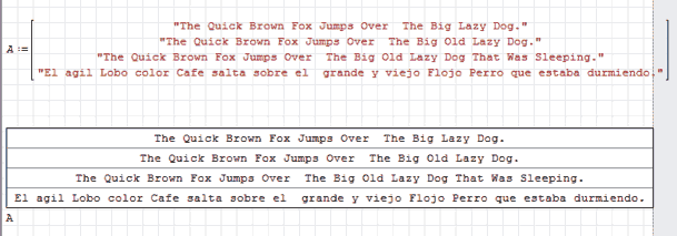

As you can see below in your example, when I PRINT, the table is cut off. All i did was download your sample and print it. As Davide said, this was an issue with the .NET framework. In any case, I appreciate the efforts to help. Thank you all very much. Hopefully Davide can eventually come up with something. In the mean time, I have used the concat() function to automatically add 4 spaces to any string i wish to display in a table. 4 spaces (as shown in a previous post) seems to cover most any length I will use.
#91 Posted: 10/25/2018 11:57:03 PM

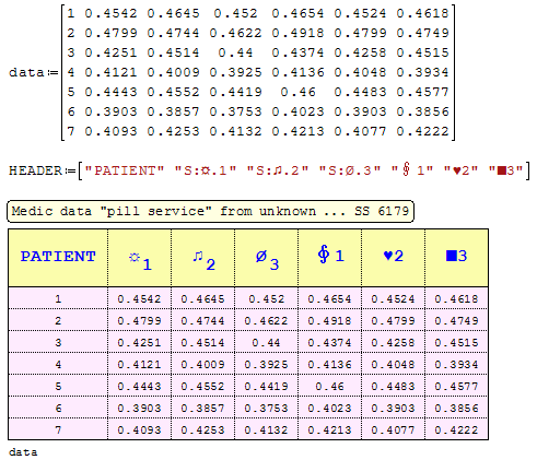

Is there another comprehensible set of symbols I could use inside this region ?
In the mean time: from Win Charmap.
