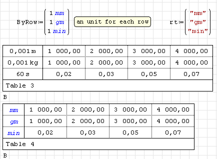

Did I get it right that the unit summary is for scaling the data by line?
By columns, by rows or global (single unit/scale factor)
[edit] attachment updated using the latest plugin's XML scheme
units.sm (21.03 KiB) downloaded 1709 time(s).

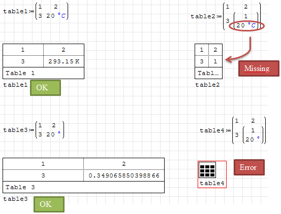

I found two issues within this plugin.
- Comma ',' as argument separator does not work probably when sub matrices are used.
- The degree symbols causes issues when sub matrices are used.
Please see my attached images.
Best Regards,
Infinity
Davide Carpi 2/18/2014 9:44:00 AM
#34 Posted: 2/18/2014 9:44:56 AM
Thank you, I'll fix it

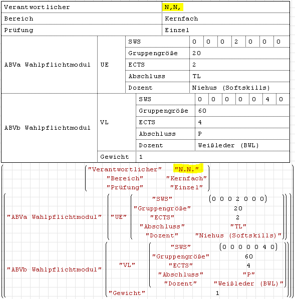

Unexpected results in Table Region. All but the first submatrices are collapsed to some strange number. Something went wrong...
NK TM1 13.sm (38.49 KiB) downloaded 1688 time(s).
Davide Carpi 4/21/2014 1:36:00 PM
#38 Posted: 4/21/2014 1:38:50 PM
Thank you Martin, bug added in the BTS (SS-120)
Best regards,
Davide
Martin Kraska 4/21/2014 3:53:00 PM
