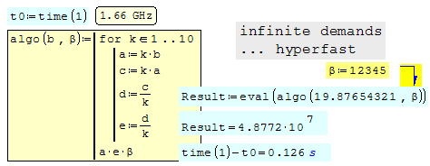

Just for demonstration purposes, I've been able to increase the speed of this calc ~25% on my machine just by using vectorization rather than the for loop. It's still not near the performance you'd like, but just goes to show there are often things to be done to improve calculation speed. Vectorization isn't always possible in some algorithms, but when it is, it's generally faster.
speedtest.pdf (35.36 KiB) downloaded 838 time(s).
speedtest.sm (8.36 KiB) downloaded 1334 time(s).

Maths algo DEMANDS.sm (5.85 KiB) downloaded 1295 time(s).
