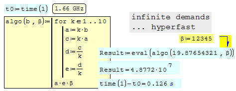

I am new here, and facing similar problems. I intend to replace MathCad to an alternative solution due to PTC's pricing and support policy. I was very happy to find SMATH, and I started to test it. For short calculations it's a good alternative, but it seems very-very slow when long iterations are needed. I made a short loop both in Mcad and Smath containing just a few multiplications, and calculating it 1000000 times took ~0.2s for Mcad14, ~1s for Mcad8, and 32s for SMATH. So now I am a bit upset...

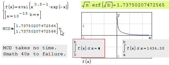

#9 Опубликовано: 28.01.2023 10:46:03
In some instances, Smath is slightly faster than Mathcad 11.
However, almost not observable.
In other instances, Smath is horribly slow.
1 min Julia in Mathcad takes over 2 hrs in Smath
Same observation Fourier CoC ... and more.
Please, attach your document for Smath Community to doctor.

#11 Опубликовано: 28.01.2023 11:50:23
SMath may not be fastest among them.
But some tricks can be applied.
It may improve calc speed slightly.

Maths algo DEMANDS.sm (5,85 КиБ) скачан 1295 раз(а).
