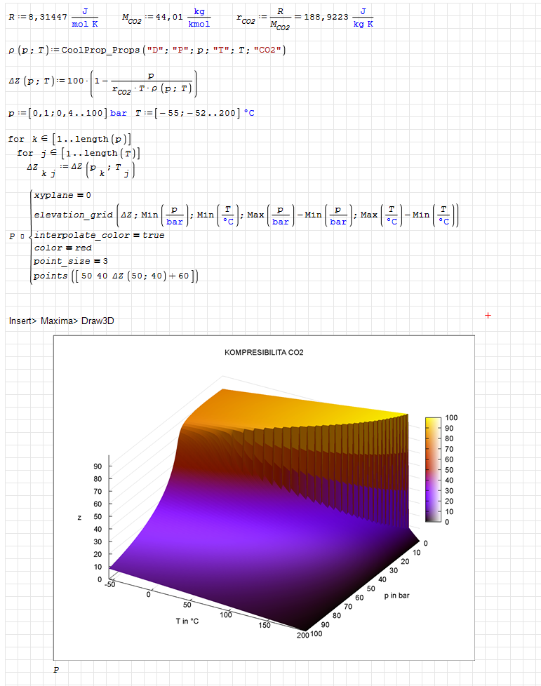

Hi, i would like to add some points to 3D plot. How can I do that?
And can i somehow make the plot smooth without using smaller steps in vectors?

You could try to create a mesh of triangles or quadrilateral objects. Then you are free to use a problem-adjusted surface parametrization.

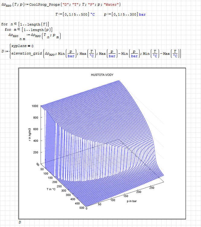

thanks for your answer. I have another question. I´m trying to make graph of water density, but the axes are not right, what is wrong?

Thanks you very much! That helped.

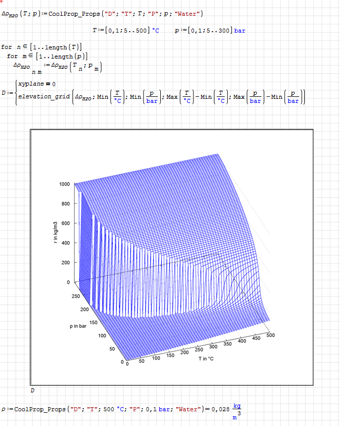

But if i want to make axes right i have to switch x and y axes in elevation grid command. I don’t know why.

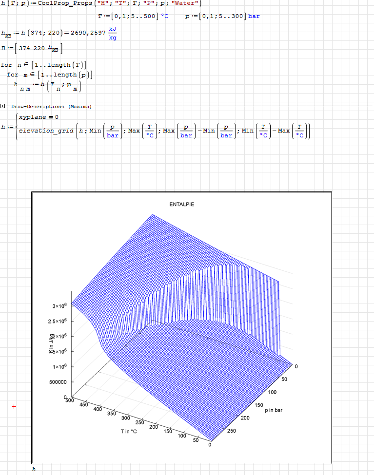

how can I add point B to plot? When I tried I make point or plot, but not both of them.

I tried to fix it and I ended with this. Still can t plot graph and point together.

You still have a negative h value (temperature difference). Reverse this (and also reverse the matrix). Then it should work.

Good to see. You also might display the z values in MJ/kg to get nicer tick labels and play around with the view parameters in the settings menu to avoid interference between axis label and tick labels.

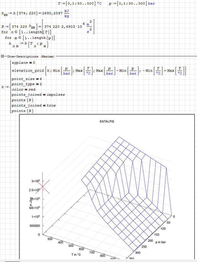

I’m back. I tried to create line of points by maxima handbook. Handbook is really great, but I couldn’t figure it out. What am I doing wrong? Matrix seems right.
And i have another question. When I created plot of enthalpy I just wrote name of the "plot function". But in the manual, there is Draw3D("plot function"). Why is that?

Your data matrix isn't in the correct format. It is a one-column matrix of row vectors. Make it a real n x 3 matrix, then try again.
Also, you use different units when filling the data matrix (J/kg) and for the axis limits (kJ/kg).

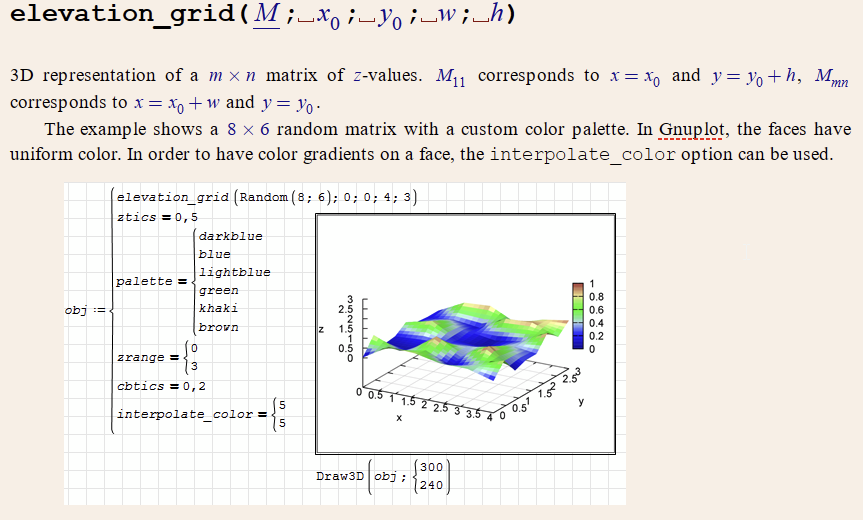

As to the Draw3D command, see intro text to Chapter 3.
