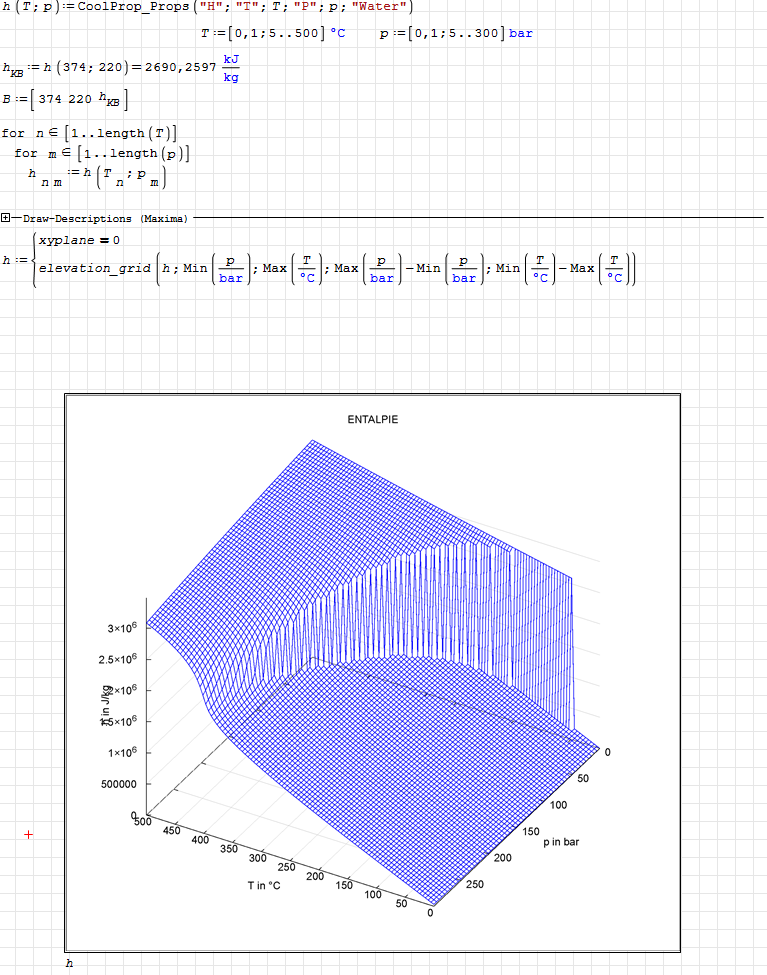

thanks for your answer. I have another question. I´m trying to make graph of water density, but the axes are not right, what is wrong?
hustota vody.sm (69 KiB) downloaded 634 time(s).
Thanks,
Tomáš
#4 Posted: 1/28/2026 12:09:04 AM
1,359 likes in 2,273 posts.
This is probably due to the "visual" indexing in the matrix.
Rows in a matrix are increasing top-down, whereas values in y are increasing bottom-up.

But if i want to make axes right i have to switch x and y axes in elevation grid command. I don’t know why.
hustota vody.sm (135.01 KiB) downloaded 643 time(s).
Is there any sheet of something like that, where I can fing all comands for plots? And how can I write them, because commands that I used, I copied from some file I found.

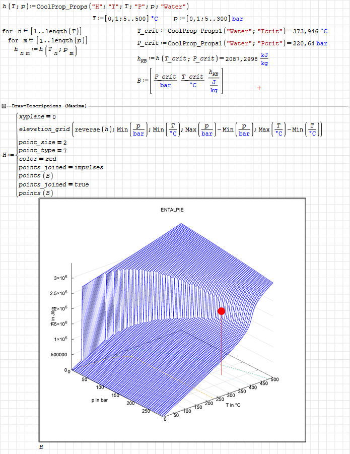

#8 Posted: 2/6/2026 11:03:04 AM
Tomas Novotny
Tomas Novotny
1 likes and 1 dislikes in 15 posts.

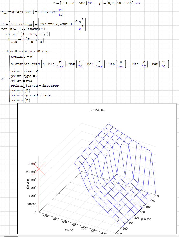

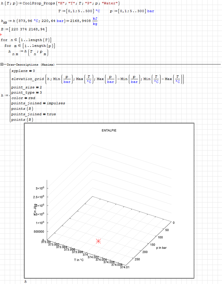

how can I add point B to plot? When I tried I make point or plot, but not both of them.
kriticky_bod.sm (202.22 KiB) downloaded 651 time(s).
Thanks for answers,
Tomas
#9 Posted: 2/6/2026 1:25:26 PM
Seems to be related to the negative temperature range in the elevation_grid command.
#10 Posted: 2/10/2026 7:29:28 AM
Tomas Novotny
Tomas Novotny
Thanks for answer,
I tried to fix it and I ended with this. Still can t plot graph and point together.
kriticky_bod.sm (201.86 KiB) downloaded 601 time(s).
What should I do now?
Tomáš
#11 Posted: 2/10/2026 3:54:04 PM
You still have a negative h value (temperature difference). Reverse this (and also reverse the matrix). Then it should work.
#12 Posted: 2/19/2026 8:34:45 AM
Tomas Novotny
Tomas Novotny
Thank you very much! It works.
Tomáš
#13 Posted: 2/19/2026 10:12:49 AM
Good to see. You also might display the z values in MJ/kg to get nicer tick labels and play around with the view parameters in the settings menu to avoid interference between axis label and tick labels.

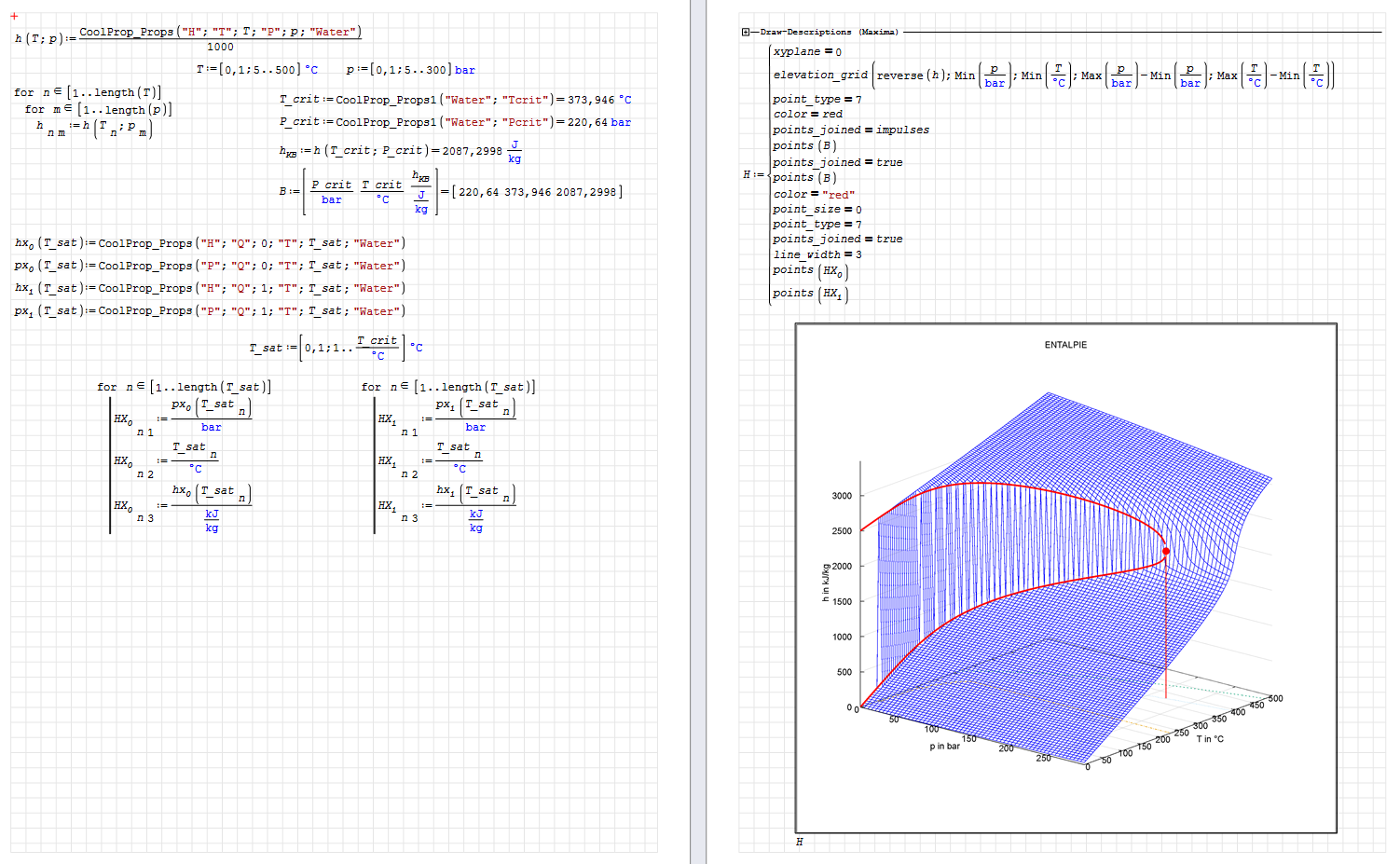

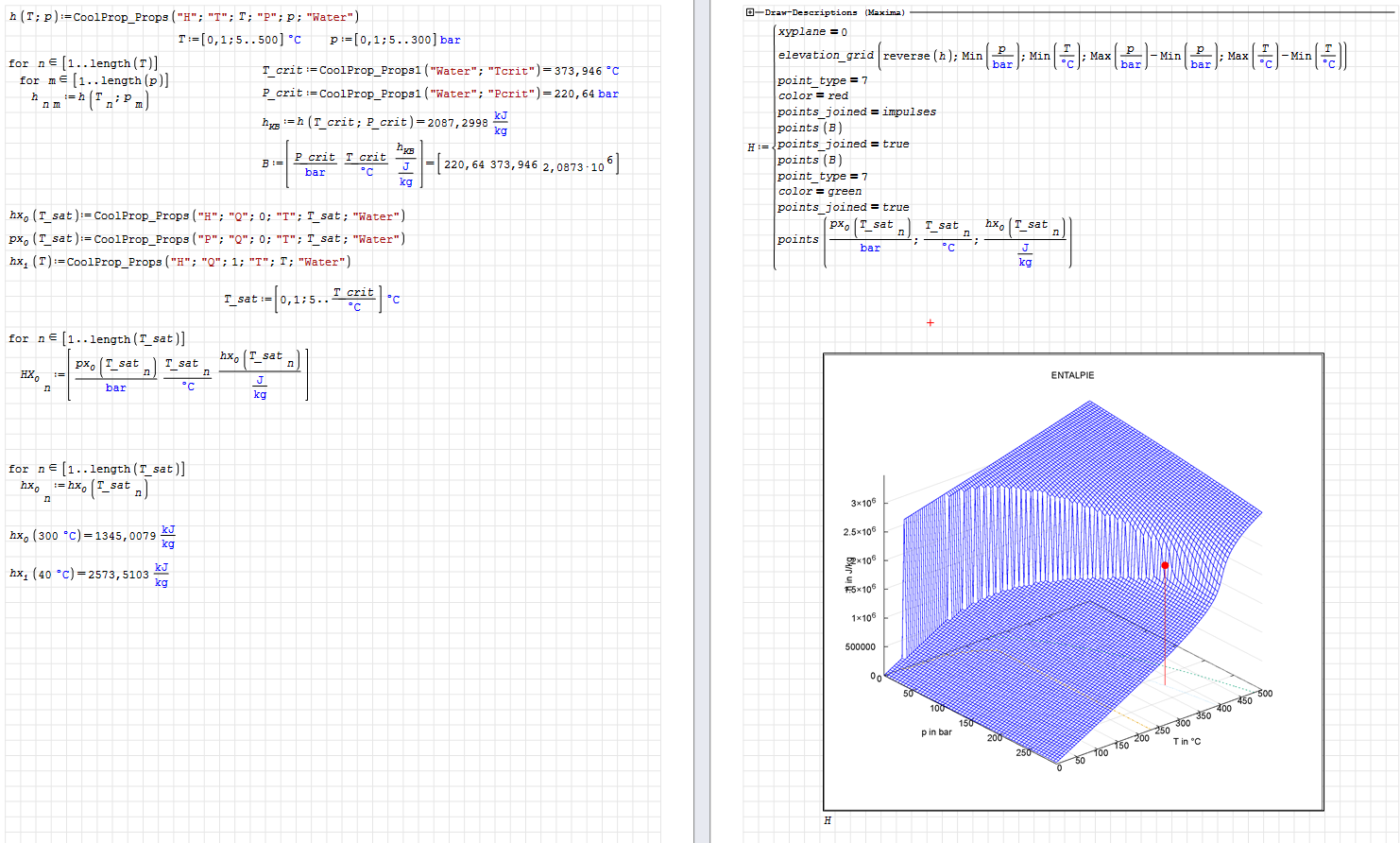

#14 Posted: 2/19/2026 11:38:12 AM
Tomas Novotny
Tomas Novotny

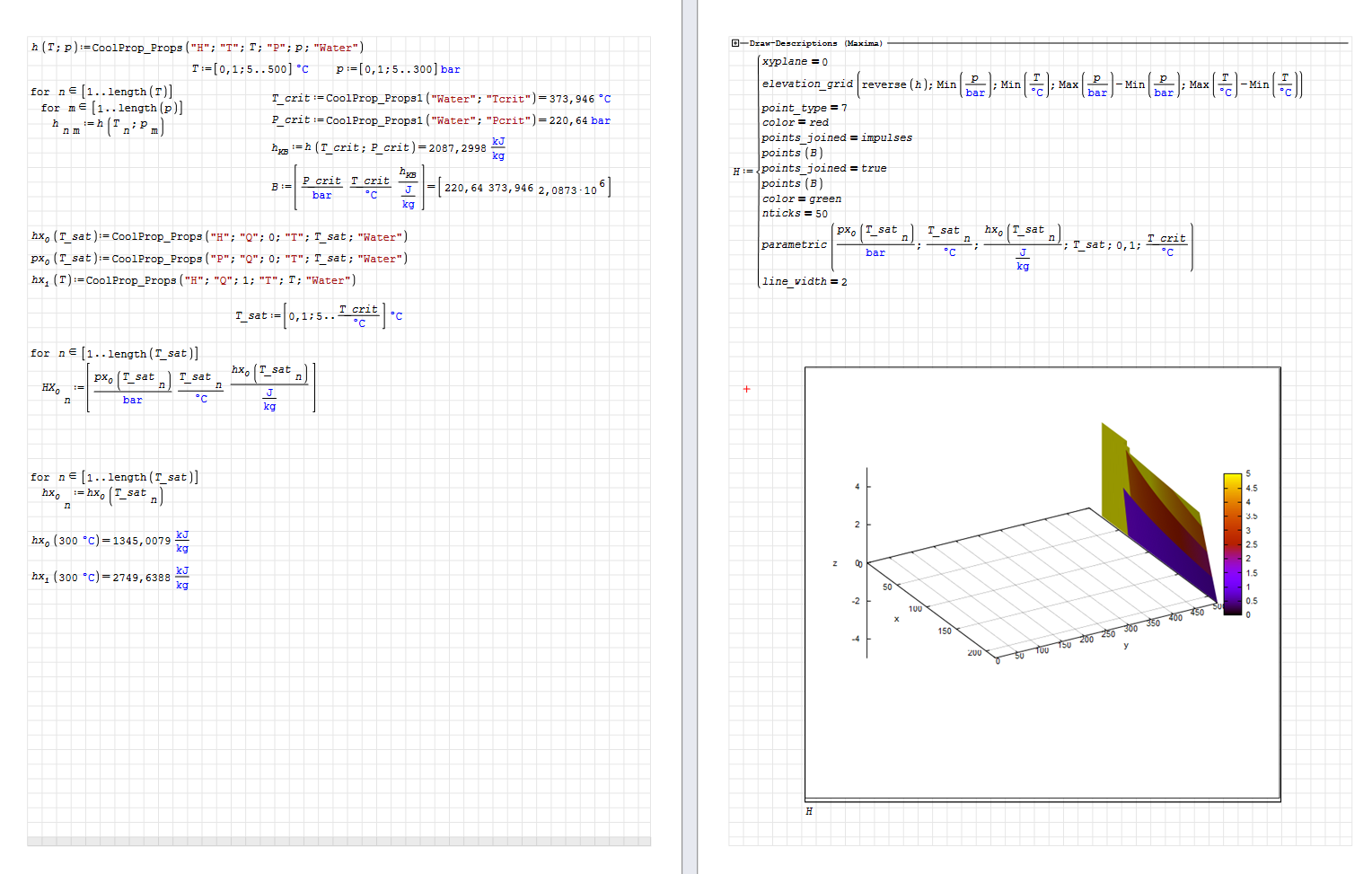

Now I would like to add saturation curve. Is it better to go with matrix or function? And how can I do that?
I tried parametric function, but plot did not work.
krit_bod_2.sm (211.84 KiB) downloaded 605 time(s).
Thanks for answers!
Tomáš
Edited 2/19/2026 12:05:07 PM
#15 Posted: 2/19/2026 1:01:39 PM
I guess it is best to use the points object just like for the single point. Set points_joined to true, point_type to something convenient. Using a function will work only if that function is supported by the interface to Maxima, which probably doesn't apply to coolprop functions or interpolated functions.

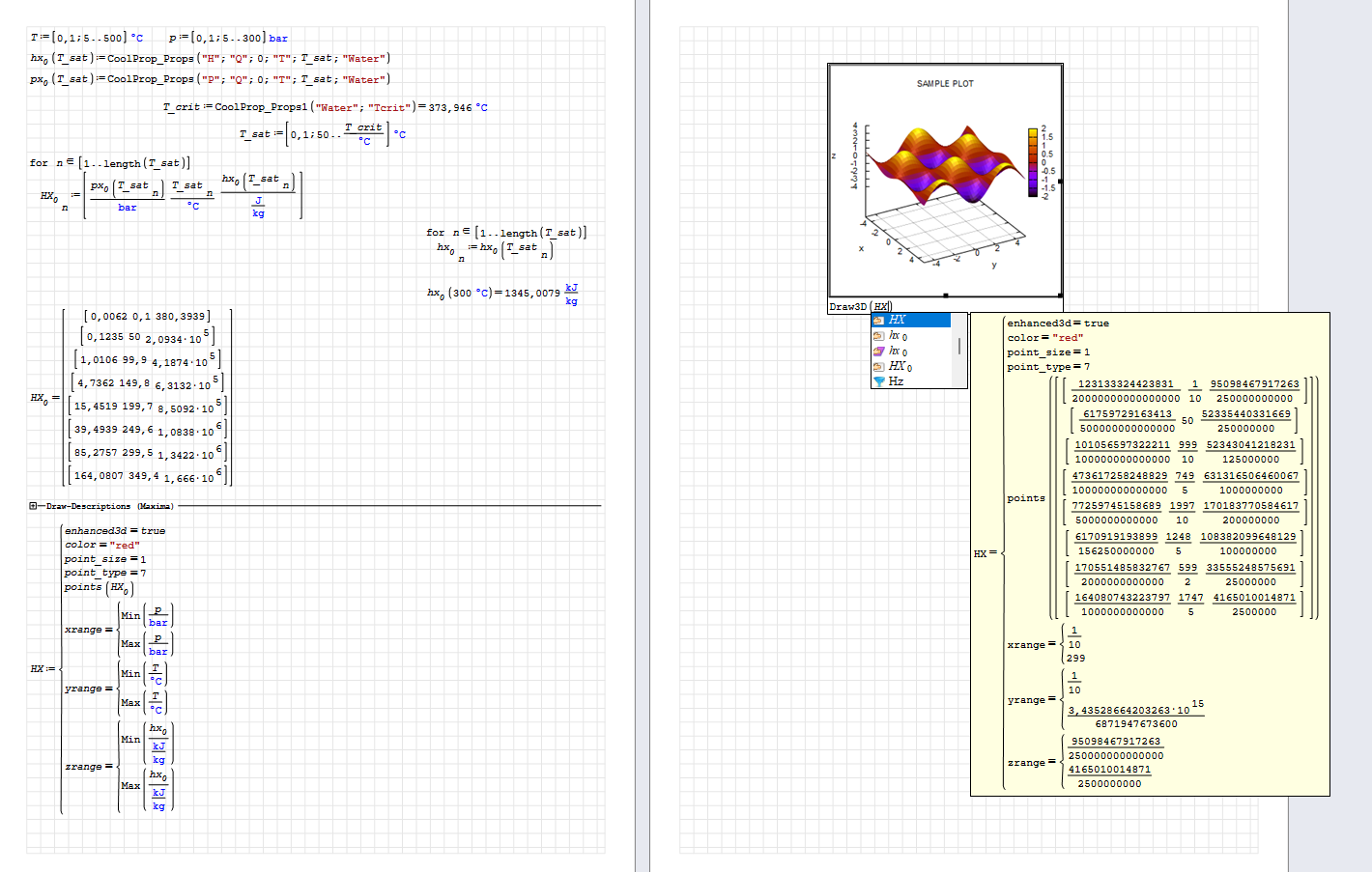

#16 Posted: 2/22/2026 6:05:46 PM
Tomas Novotny
Tomas Novotny

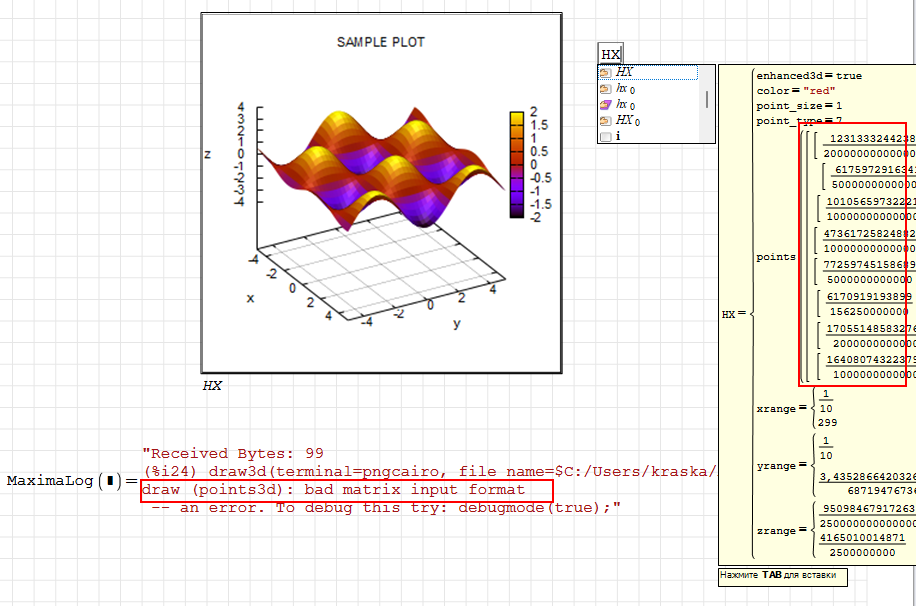

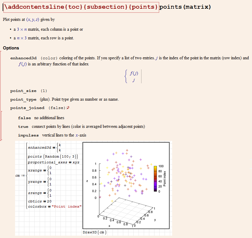

I’m back. I tried to create line of points by maxima handbook. Handbook is really great, but I couldn’t figure it out. What am I doing wrong? Matrix seems right.

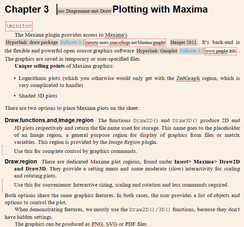

And i have another question. When I created plot of enthalpy I just wrote name of the "plot function". But in the manual, there is Draw3D("plot function"). Why is that?
saturation_curve.sm (194.75 KiB) downloaded 559 time(s).
Thanks for your help and patient, I really appriciate it.
Tomáš
#17 Posted: 2/23/2026 10:20:19 AM
Your data matrix isn't in the correct format. It is a one-column matrix of row vectors. Make it a real n x 3 matrix, then try again.
Also, you use different units when filling the data matrix (J/kg) and for the axis limits (kJ/kg).
As to the Draw3D command, see intro text to Chapter 3.
