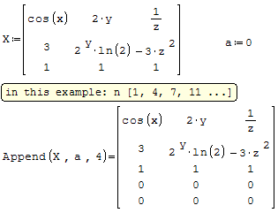

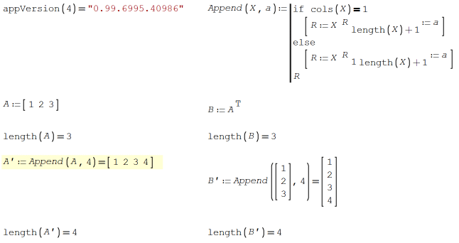

Hi. Is this the expected behavior?
Append.sm (6.87 KiB) downloaded 1440 time(s).
I hope not. I expect A' = [1 2 3 4]

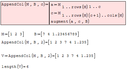

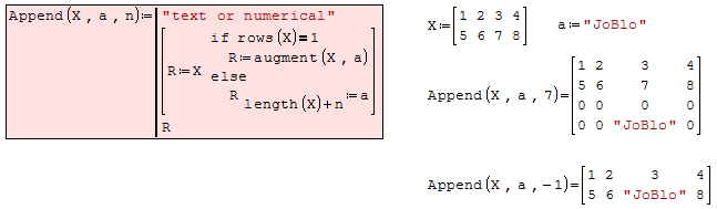

Alvaro: maybe like this ?

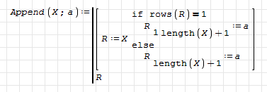

Hi Jean. Nope, maybe more like this:
BTW, this is a workaround. I expect this result but for the previous syntax.
#4 Posted: 2/27/2019 10:20:41 PM
You just append, my code inserts wherever needed.
My mistake I named Append(,,,)
OK, you are imitating MCD.
Simpler Append: transpose the row, stack, re-transpose.

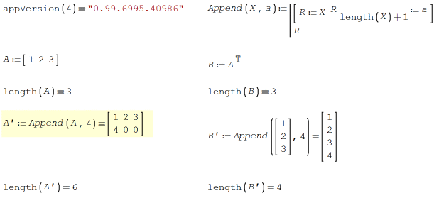

Yes it is correct, or at least it conforms with the general approach of the program (vectors are single column matrices, anything else is a matrix). You might see it better in a 2 rows matrix:
The new indices are added expanding the matrix vertically; there is no special case for single-row matrices.

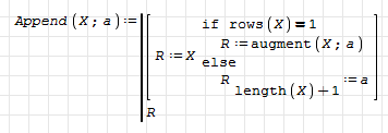

For your task, one way could be this:
Or this:

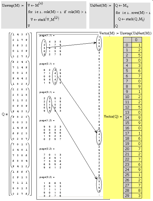

Matlab => MDA [Muliti Dimensional Array]
Mathematica => Cell Array
They just have their system. I can do whatever from this example
and very quick too, just few more modules.
