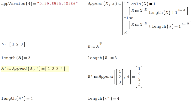

Hi. Is this the expected behavior?
Append.sm (6,87 КиБ) скачан 1440 раз(а).
I hope not. I expect A' = [1 2 3 4]

Hi Jean. Nope, maybe more like this:
BTW, this is a workaround. I expect this result but for the previous syntax.

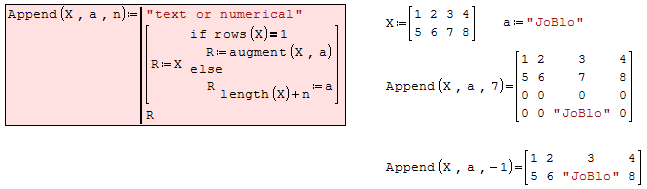

My mistake I named Append(,,,)
OK, you are imitating MCD.
Simpler Append: transpose the row, stack, re-transpose.

I'm trying to imitate Wolfram's Mathematica Append.

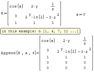

Yes it is correct, or at least it conforms with the general approach of the program (vectors are single column matrices, anything else is a matrix). You might see it better in a 2 rows matrix:
The new indices are added expanding the matrix vertically; there is no special case for single-row matrices.

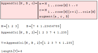

For your task, one way could be this:
Or this:
