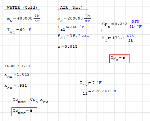

So I am having issues with the temperature units I need to multiply a specific heat value [BTU/lbm*F] by a constant that modifies to the actual Cp value. I keep getting a error? I think it has to do with the units im inputting what can i do to fix this? also I would like to know if its possible to have the output of my units to be automatically changed between English to SI or SI to English as well?

Be careful with temperature units. You have the temperature units and the temperature difference units.
Units temperature

Thank you Radovan,
That helped a lot I had no idea smath supported a
temperature difference.
