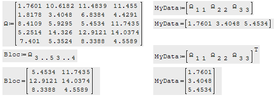

#3 Posted: 9/28/2021 8:37:33 AM

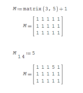

#4 Posted: 9/28/2021 9:17:41 AM
... observe the empty place holder is a / operator.

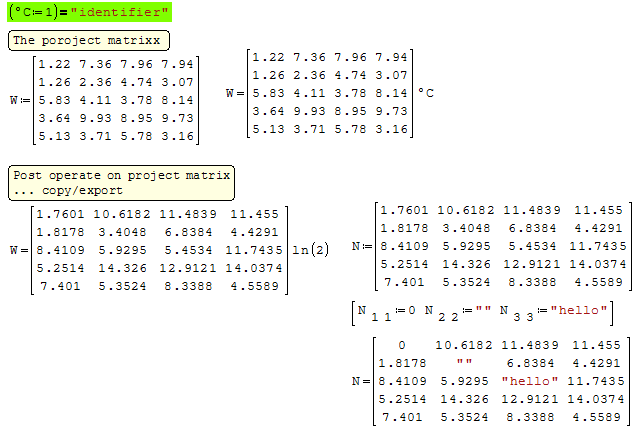

#6 Posted: 9/28/2021 11:15:31 AM
Thank You Jean, but rather, I meant to extract a specific element from the matrix.
There are many more ways ... like skinning a cat.
Cheers ... Jean.

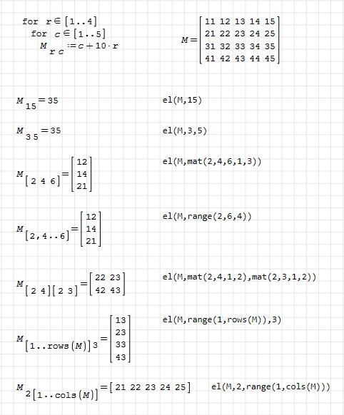

#8 Posted: 9/28/2021 4:21:01 PM
1,139 likes in 1,805 posts.
Hi. There are many different ways to access the elements of an array. This list is not exhaustive, and does not include the submatrix function.
M.sm (10.01 KiB) downloaded 1234 time(s).

#11 Posted: 9/30/2021 1:37:31 PM
... One more thing, how do you write the range of elements in an array? Regards Adam
Use vector element
or matrix element
and then put a range (with 2 or 3 arguments) in the index placeholder
