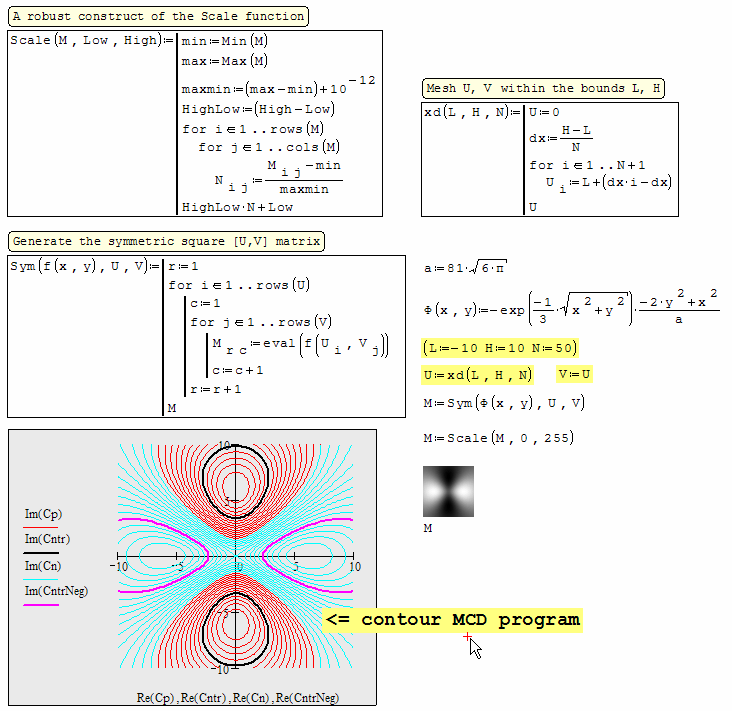

Jean, on a side note, what is your comment on a quality of DISLIN generated plots?
There are already so many 3D plots, many are freeware.
Scilab, DISLIN ... Surfer 8 [dedicated Contour plot, not freeware].
I see DISLIN via a menu driven and equation editor, Mathcad style.
The first thing is a the same CreateMesh than Mathcad. Let say the
two planes X, Y and the level Z plane and in parametric style.
That sets the complete 3 D system, meshed at will and supporting
the entire user rotation from command line as well as cylindrical/
spherical plots and export the corresponding matrices. Contour is
something else of much different nature. Contour plots ends being
an XY plot. I have a Mathcad contour program [done by Collab].
Just scared to attempt Coding in Smath. Some of you gurus, I can
make an image of the program for your bed time reading.
There remains the question about freeware: how far can somebody
reverse Engineer and redistribute ?
Cheers Alex, Jean

... that's what I meant about a comprehensive "DISLIN start".
Contour is for exporting specific contour data. The feed is a
matrix, either well populated or splined and you get what you
want. Collapse the function, plug the matrix from source or
from function ... ready for the contour(s), just few clicks.
I lost patience trying to imitate Mathcad "on error".
So, attempting the program is not tempting.
The program images included in the *.sm work sheet.
Contour Electron.sm (239.09 KiB) downloaded 2173 time(s).

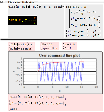

#46 Posted: 11/4/2020 11:36:55 PM
... native SS 6179 ... sorry but I have no interest *.svg
Stand alone user command line is more my cup of tea.

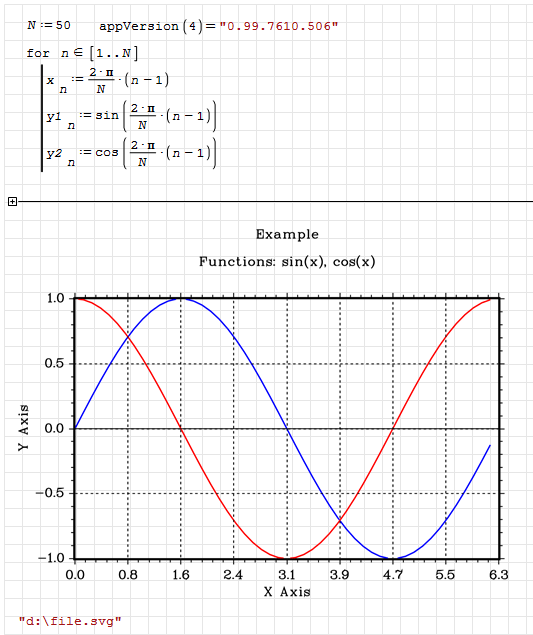

Updated.
Changes:
- updated to DISLIN 11.3.3 (799 functions);
- refactored.
Quote
Grant of Free Usage
You are allowed to use DISLIN for free. Either as a private person or in a
commercial or non-commercial environment. There are no limitations.
Click to enlarge
DISLIN. Example 1.sm (95.34 KiB) downloaded 2203 time(s).
DISLIN. Example 1.pdf (287.2 KiB) downloaded 1525 time(s).
