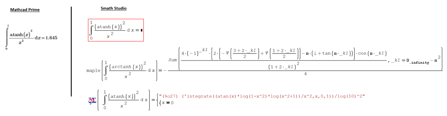

Another integral which Smath cannot solve while Mathcad Prime can:
#2 Posted: 12/26/2024 5:20:48 AM
1,111 likes in 1,788 posts.
Maple provides the exact solution as an infinity sumatorie. Whether that expression is useful or too unwieldy is another question.

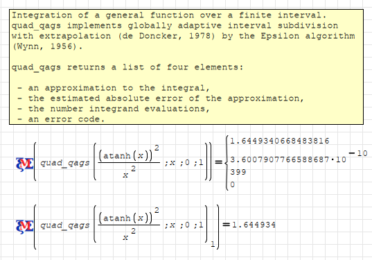

This will be a very late reply, you can even call it necroposting.
But I think it will be useful for some maxima users.
For finite integrals wouldn't be solved easily, use quadpack.
https://maxima.sourceforge.io/docs/manual/Integration.html#Integration
sergio 4/22/2026 8:33:42 AM, ioan92 4/24/2026 1:53:15 PM
