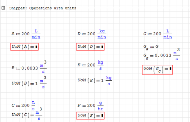

Hello
The unit operation snippet fails to detect units.
Snippet_Units_Fail.sm (33.04 KiB) downloaded 1680 time(s).

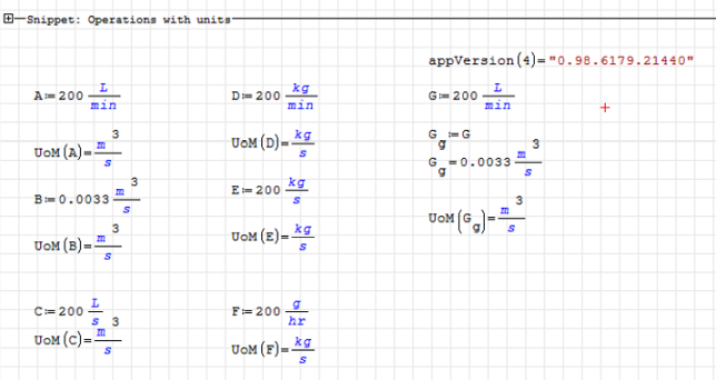

#2 Posted: 5/17/2022 9:02:34 AM
Try this
Snippet_Units_Fail.sm (32.38 KiB) downloaded 1601 time(s).

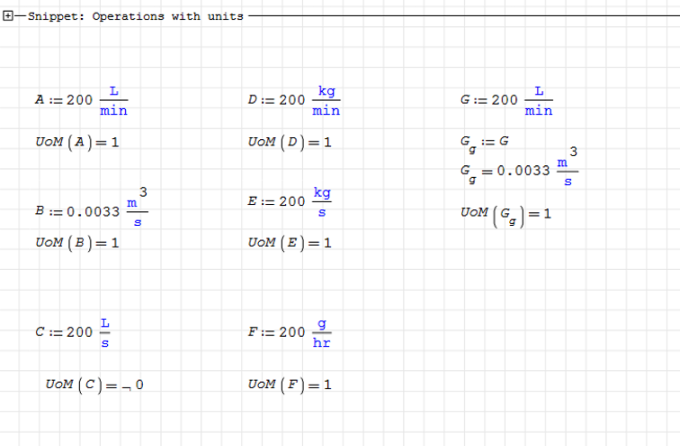

#4 Posted: 5/17/2022 4:51:34 PM
CBG
CBG
78 likes in 312 posts.
Hello David
Quote
Try this
Thank you very much for your answer, but the snippet fails, since instead
of finding the units, it only obtains the value of 1
Hola Jean
Saludos
#5 Posted: 5/18/2022 4:44:35 AM
Hello David
My bad, IDK why but yesterday seemed to work to me, but in fact it doesn't. I'll give another look at the snippet ASAP.

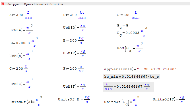

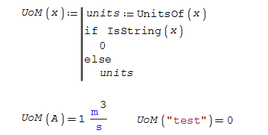

#8 Posted: 5/19/2022 8:28:50 AM
I'm not sure, however if you need a urgent fix here you have an easy way to make it working the same way.
