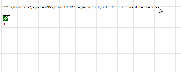

#23 Posted: 8/26/2013 2:14:20 PM
UPDATED
Just to complete the early introduced feature
- converter on paste accept command-line strings (input string: "ProcessToStart"[space]Flags)
so when you paste in the placeholder something like:
"C:\Windows\system32\rundll32" sysdm.cpl,EditEnvironmentVariables
this will become:
"'C:\Windows\system32\rundll32' sysdm.cpl,EditEnvironmentVariables"

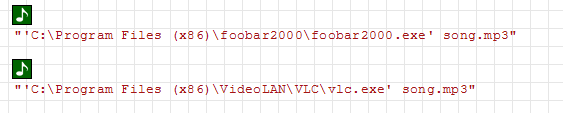

Just found out about this plugin.
Thanks for the work man.
Just a few quick questions,
lets say i wanted to open up a file with a specific program, what would i type into the hyperlink?
for example, lets say i wanted to open up
song.mp3
with the executable
C:\foobar\foobar.exe
#27 Posted: 9/11/2013 3:13:36 PM
1,360 likes in 2,275 posts.
song.mp3
with the executable
You might try the approach shown in post23.
Use "'C:\foobar\foobar.exe' song.mp3". It is essential to quote the executable path with ', otherwise windows takes the space as part of the prog name.
#28 Posted: 9/11/2013 5:50:46 PM
Exactly
with foobar, if your song contains some spaces use wildcards (*) instead of spaces (f.e. this doesn't work in vlc; I'll think to another approach or another solution to fix this - maybe a double single quotation to have a double quotation or a context menu dialog...)
regards,
Davide

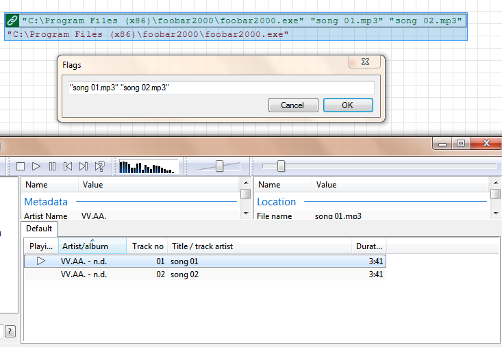

#30 Posted: 10/6/2013 8:09:31 PM
UPDATED
- Flags input moved from the placeholder to a dedicated context menu item.
This solve double quotes issues involving flags and SMath strings.
- PASTE feature works also with the new input way.
(TEMPORARY feature) To update worksheets containing the old syntax ("'process' flags"):
- open the worksheet
- save the worksheet
- close and open again the worksheet
- delete all except the process name from the input placeholder
regards
Davide

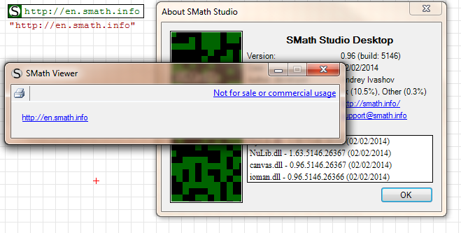

I am using it with version 0.96.5146 but generation
of executable version (viewer) doesn't work for me.
Is that known issue ?
#35 Posted: 2/4/2014 7:08:28 AM
Hello, I can't reproduce the issue... could you attach a file that doesn't work for you?
#36 Posted: 2/4/2014 8:10:27 AM
dyleks
dyleks
0 likes in 4 posts.
The issue is solved.
After SMath was restarted it works.
Sorry for bothering you.
