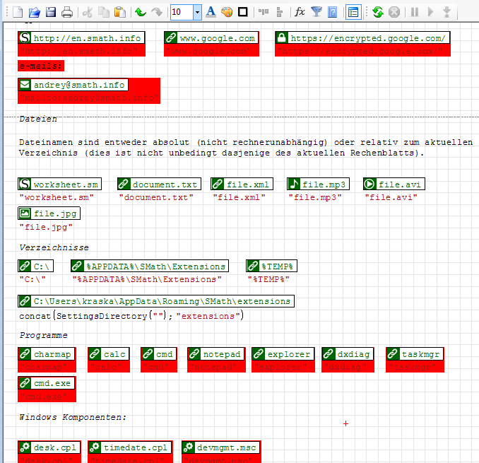

Davide, I experience strange problems with hyperlinks with SMath 0.98.6179 and a fresh hyperlink region plugin.
The links in your docs (from post #1) work fine.
If I copy them to my handbook page, I get "System can't find the file" messages for the links marked with red background, both documents in the same instance of SMath. No matter if portable or installed distribution...
There must be something wrong with my document...

#43 Posted: 1/2/2017 12:35:03 PM
Try now, it should be fixed.

#56 Posted: 9/26/2018 2:48:08 PM
1,360 likes in 2,275 posts.
The link text seems to be cut off in 6824 and newer (perhaps also older).
Davide Carpi 9/27/2018 7:06:00 AM
#57 Posted: 9/26/2018 7:07:46 PM
Thank you Martin, confirmed and fixed.
seems there are issues with the Release Manager today, I'll deploy the updated extension as soon as it will be possible
