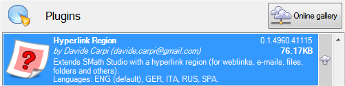

#4 Posted: 7/31/2013 6:06:14 PM
First Beta available through plugin's Gallery.
Documentation and translation sheet in the first post.
Best regards,
Davide

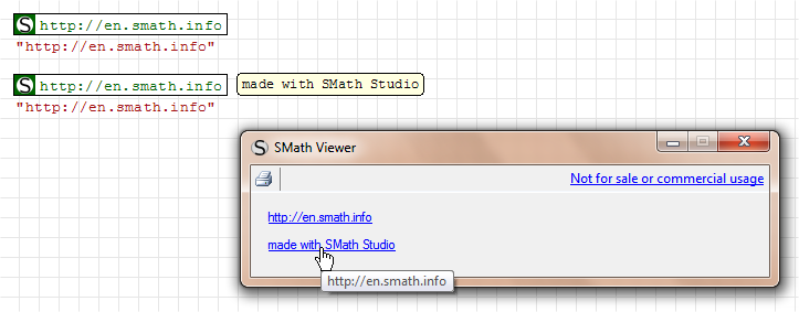

#7 Posted: 8/1/2013 7:52:20 AM

#11 Posted: 8/2/2013 7:05:07 AM
Under windows, the %APPDATA% and the SettingsDirectory() approach work, but how is that under linux?
I've not yet tested the plugin under linux, I don't know...
This rises the question, why there is special treatment for string constants in math expressions at all.
I suppose that's possible for texts that contains characters not available for the variable names (such spaces or slashes and backslashes), when you paste something in a placeholder; for the canvas someone may would paste text as text, so a "paste as" would be needed (or a "post-paste context menu item" like in MS word)
#12 Posted: 8/2/2013 5:51:25 PM
UPDATED
- Support for SMath Viewer
best regards,
Davide

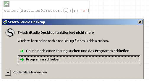

#15 Posted: 8/9/2013 6:35:53 PM
1,361 likes in 2,275 posts.
SMath crashes when I try to edit the input expression of a hyperlink.
I write concat with three arguments, fill in the first and the last. As soon as I want to type to the second placeholder, the crash occures.
#16 Posted: 8/9/2013 7:07:15 PM
Fixed, please test the update
best regards,
Davide
Martin Kraska 8/9/2013 7:34:00 PM
#17 Posted: 8/9/2013 7:35:26 PM
That was fast... Thanks a lot.
#18 Posted: 8/9/2013 8:02:03 PM
You're welcome; I've already noticed the bug working to another plugin
