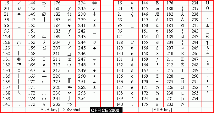

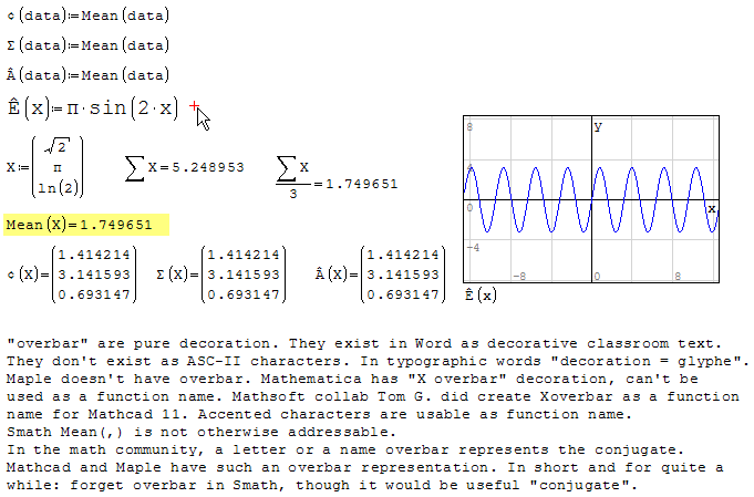

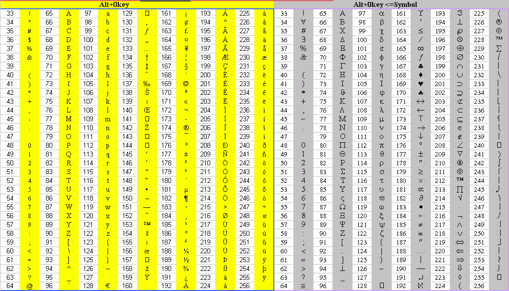

#3 Posted: 12/7/2016 11:29:19 AM
... these two may be useful. Unlike Mathcad that has the
symbol option over a character, Smath does not have.
Too much personalisation is not desirable. A good example
is Mathematica "Conjugate" ... must write in full !!!

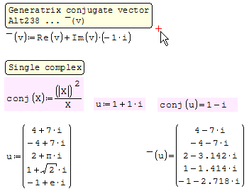

#4 Posted: 12/7/2016 12:22:32 PM
... overbar conjugate:
