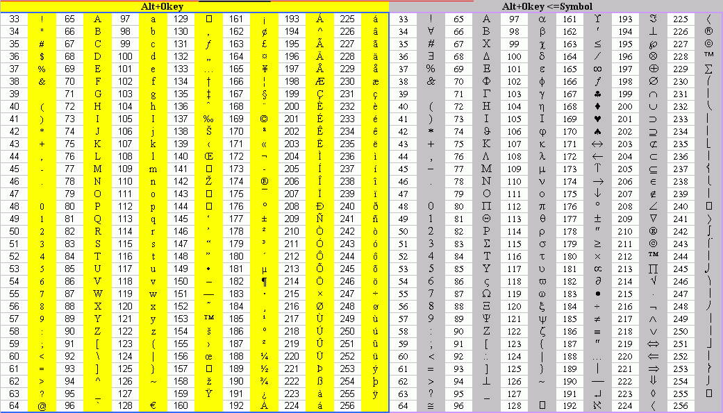

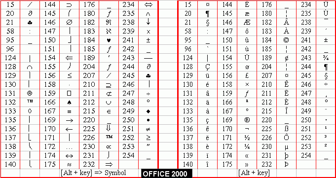

That's all what I can help/answer. Please: don't hesitate
to visit the forum for any kind of question you may have.

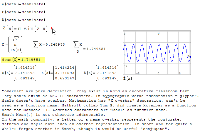

#3 Опубликовано: 07.12.2016 11:29:19
... these two may be useful. Unlike Mathcad that has the
symbol option over a character, Smath does not have.
Too much personalisation is not desirable. A good example
is Mathematica "Conjugate" ... must write in full !!!

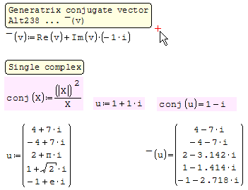

#4 Опубликовано: 07.12.2016 12:22:32
... overbar conjugate:
