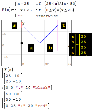

#5 Posted: 10/13/2019 11:00:11 PM
What am I missing here ?
You are missing to plot the literal demo diagram,
here is as per your inputs [a,b,s,t].
More is missing from incomplete project description.
Reflection [abst].sm (62.14 KiB) downloaded 762 time(s).

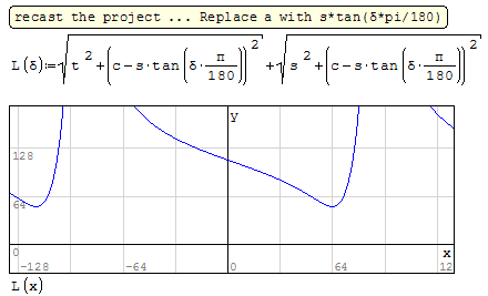

#6 Posted: 10/14/2019 11:27:00 AM
Refreshed from your literal inputs.
You may have to revisit your College Physics book.
Cheers ... Don't hesitate.
Reflection [abst].sm (128.95 KiB) downloaded 752 time(s).

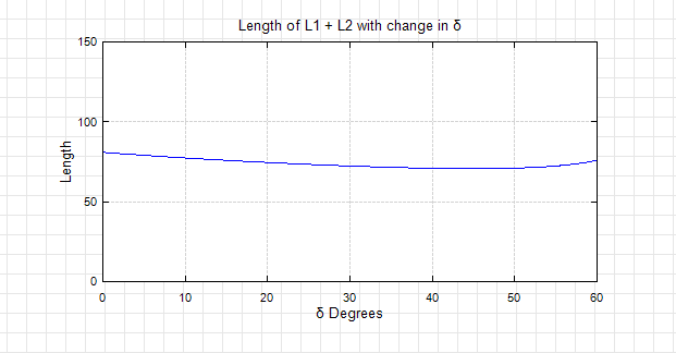

Yes the length L is continuous with respect to ddegrees. I think Jean misunderstands the question. See attached. (A little sloppy but it works)
Edit: Updated graph to add labels
Edit2: Had an error in definition of L. Fixed.
Reflection_alyles.sm (177.77 KiB) downloaded 1016 time(s).
Quite right: misunderstood the travelling distance vs °incidence.
Thanks, interesting project. We need more real projects.
Reflection [abst, alyles].sm (186.64 KiB) downloaded 807 time(s).

FYI Jean you're using one of my earlier files where I had a copy paste error in the derivation of L(d), the second root term should only have s*tan(d*pi/180). You can get rid of the "c-"
#11 Posted: 10/14/2019 5:47:14 PM
Thanks ... updated.
The model fit is brute force, limited.
From my 100's models, not one immediate.
If interested: let me know, not sure if possible.
Reflection [abst, alyles].sm (209.76 KiB) downloaded 800 time(s).
