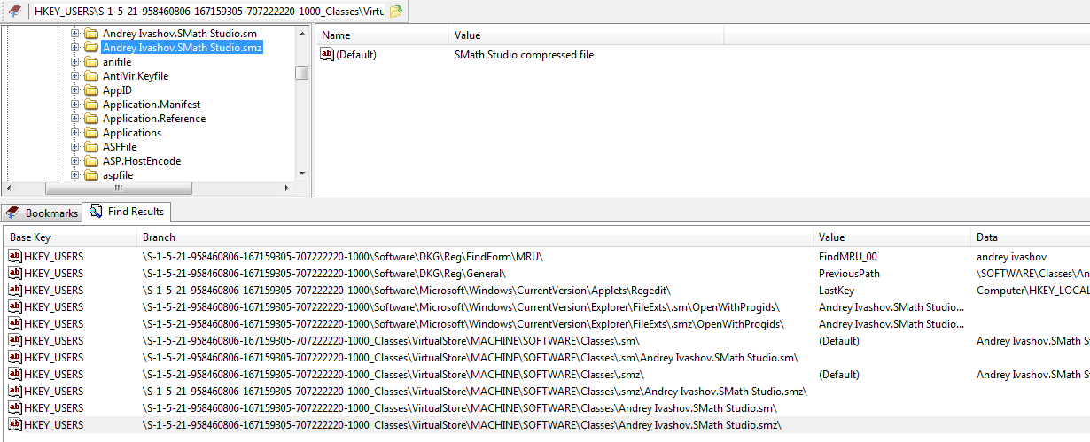

Since I have installed Smath Studio, AdwCleaner found four suspicious registry keys. Here is the report :

Clé trouvée : HKCU\Software\Classes\Andrey Ivashov.SMath Studio.sm
Clé trouvée : HKCU\Software\Classes\Andrey Ivashov.SMath Studio.smz
Clé trouvée : HKU\S-1-5-21-295457093-2378653176-778422176-1000\Software\Classes\Andrey Ivashov.SMath Studio.sm
Clé trouvée : HKU\S-1-5-21-295457093-2378653176-778422176-1000\Software\Classes\Andrey Ivashov.SMath Studio.smz
Is it positive falses ?

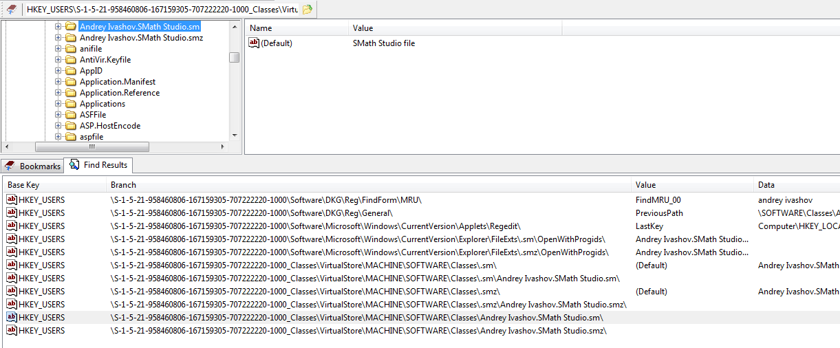

These are registry keys about file type description for the current user
Quote
HKCU - Abbreviated from the registry key name HKEY_CURRENT_USER. HKCU stores settings that are specific to the currently logged-in user. The HKCU key is a link to the subkey of HKEY_USERS that corresponds to the user; the same information is reflected in both locations.
Quote
HKU - Abbreviated from the registry key name HKEY_USERS. HKU contains subkeys corresponding to the HKEY_CURRENT_USER keys for each user registered on the machine
