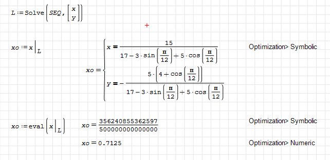

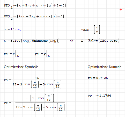

How to turn of the decimal values in trygonometry angles value? I got sth lik this for solution of system of equations:
The file with example: example_v1.sm (8 KiB) downloaded 1201 time(s).
A.

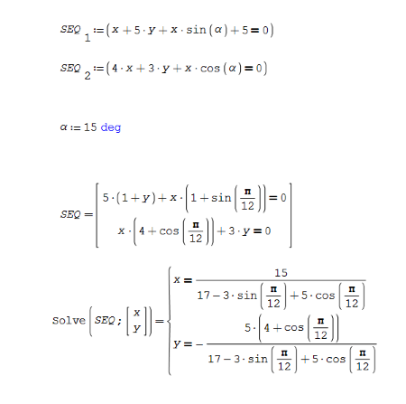

You can use the function al_nlegsolve with any initial
assumptions (because the equations are linear)
al_nlegsolve.sm (11.18 KiB) downloaded 1200 time(s).

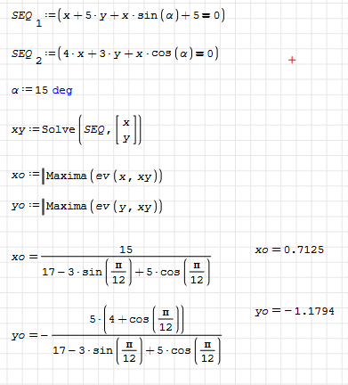

Hi. You also can use Maxima commands, in this case ev():
#5 Posted: 9/10/2021 5:37:18 AM
1,362 likes in 2,276 posts.
example_v1.sm (13.63 KiB) downloaded 1214 time(s).

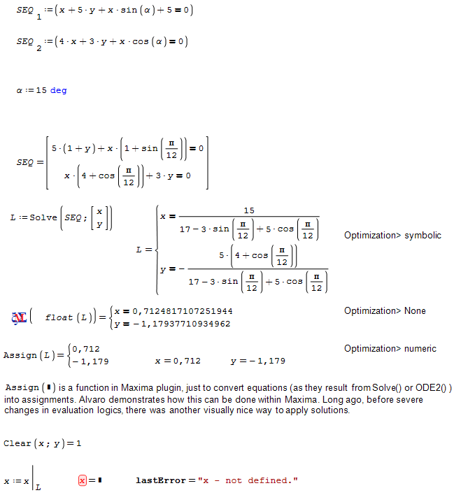

Hi Martin. I use Maxima's ev() because SMath's Assign() only works with the variable names, instead others, like xo, yo, and SMath's at() doesn't works for the symbolic evaluation, as shown this picture:
example_v1.sm (15.95 KiB) downloaded 1193 time(s).
This is a workaround for use only SMath native functions or plugins, without any explicit Maxima function:
example_v2.sm (15.16 KiB) downloaded 1262 time(s).
