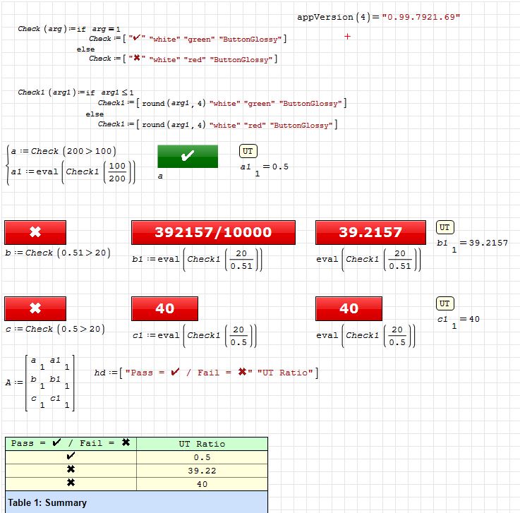

SMath Forum SMath Studio Bugs & Problems Conditionally formatted Buttons, non exact answers 1 Pages (2 items) Conditionally formatted Buttons, non exact answers - Messages Go to last post #1 Posted: 1/10/2022 7:22:15 AM ianlh 0 likes in 38 posts. Group: User Hi,I have been playing with the buttons and have found a possible bug when assigning a variable to the input data, see the image below and the second red button, compared to the third red button:more buttons.sm (18.14 KiB) downloaded 1549 time(s).Is this a real bug?Thanks #2 Posted: 1/10/2022 1:21:59 PM Alvaro 1,139 likes in 1,805 posts. Group: User Wrote ...Is this a real bug?ThanksHi. I don't know if it is, but looks like a real bug. BTW this is a workaroundBest regardsAlvaro. 1 Pages (2 items) New Posts No New Posts
