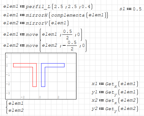

if we define a figure with its
matrix coordinates
we can use these functions to
rotate, scale, move, mirror, or offset
ToolsTransformaciones.sm (14.16 KiB) downloaded 1601 time(s).
calculation of geometric properties
PropGeom.sm (40.19 KiB) downloaded 1679 time(s).
functions to easily define some geometric figures
GeneradorDePerfiles.sm (168.5 KiB) downloaded 1659 time(s).
simple example
(maybe unfinished ... I don't remember)
perfil doble.sm (13.86 KiB) downloaded 1548 time(s).
I hope it will be useful to someone

#2 Posted: 12/14/2021 7:54:50 PM
WroteI hope it will be useful to someone
Maybe not so much if not illustrated.
Maths Polygon Esplina Intersection.sm (32.98 KiB) downloaded 1533 time(s).
#3 Posted: 12/15/2021 7:29:17 AM
WroteMaybe not so much if not illustrated.
Meanwhile, he already implemented profile plotting.
Don't mind him churichuro, he is the noodge of this forum.
This is a good example.
There is also a marvelous example written by Davide.
Check that too, it has a lot of features.
It can be downloaded via Tools>Plugins>Examples.
https://en.smath.com/forum/yaf_postst1737_PolyProperties.aspx

Thanks Overlord, I didn't know that there was already a job as impressive as Davide's, it's really great!
it was still a great implementation exercise using smath
to good effect for a Sunday morning project.
I wrote it about four months ago but I never had time to do a decent documentation.
