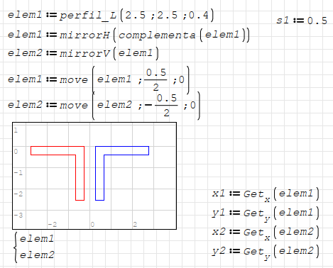

if we define a figure with its
matrix coordinates
we can use these functions to
rotate, scale, move, mirror, or offset
ToolsTransformaciones.sm (14,16 КиБ) скачан 1601 раз(а).
calculation of geometric properties
PropGeom.sm (40,19 КиБ) скачан 1679 раз(а).
functions to easily define some geometric figures
GeneradorDePerfiles.sm (168,5 КиБ) скачан 1659 раз(а).
simple example
(maybe unfinished ... I don't remember)
perfil doble.sm (13,86 КиБ) скачан 1548 раз(а).
I hope it will be useful to someone

Maybe not so much if not illustrated.

Meanwhile, he already implemented profile plotting.
