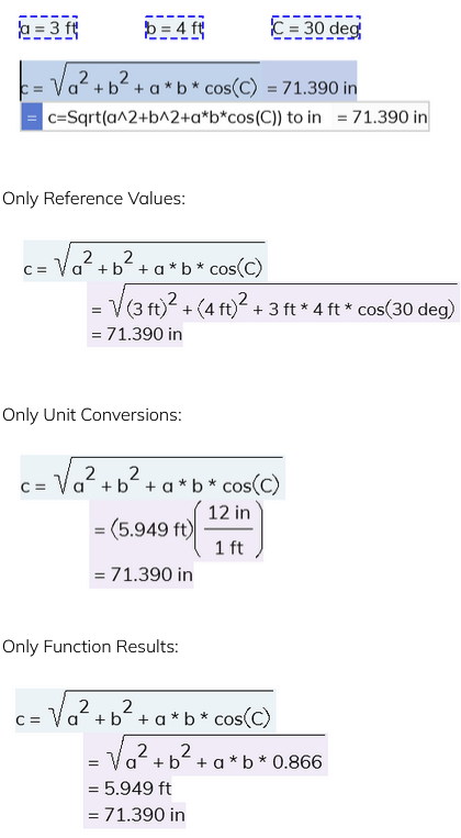

I think you want something like this (as in Blockpad)
Also LibreOffice with the iMath-extension can produce such displays, yet you have to input some formatting codes in the formula editor.
