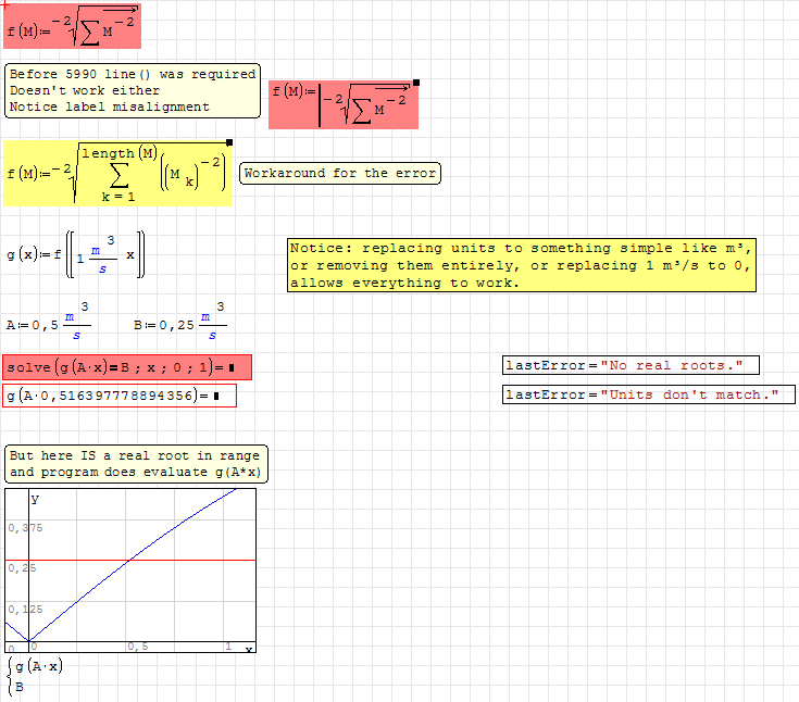

Mike Kaganski
184 likes in 434 posts.
solvQerr.sm (9.17 KiB) downloaded 1638 time(s).
С уважением, Михаил Каганский

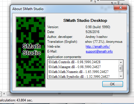

Ruben Sidranski
Ruben Sidranski
17 likes in 465 posts.
I found a bug in this version. Took over 5 minutes before I terminated the file. I took a snapshot with the timer running (shows 43 seconds) after Jean confirmed 5 seconds on his machine using version 5346.
Is this supposed to take over 5 minutes to calculate? May be SMath as this is the second sheet today that "locks-up" with the calculation tool bas and the timer running
Re-download in case something got wrong in the transmission.
XP Home, 1.8 GHz, Smath 5346 OFFicial release => 5 seconds
Inst_Viscosity Water.sm (52.14 KiB) downloaded 1761 time(s).
Would be interesting more collabs test the timing, thanks.

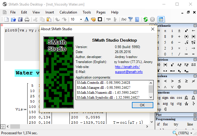

Ruben Sidranski
Ruben Sidranski
Mike,
Still seems like a computational bug. Mine went 5 minutes before I closed it down

Ruben Sidranski
Ruben Sidranski
Yes, but is this truly SMath bug? Or some extension's? Did you try to investigate before writing "I found a bug" to the New Smath Version advertisement topic?
I have no maple/maxima on my system, could that be a thing?
That was partial answer. I just upgraded to 5997 and there was an update to the Maple V wrapper. System went 14 seconds before I terminated it. I disabled the plugin and it took .98 rev 5997 0.760 seconds to process. Andrey fixed something in the new version as I was over 14 seconds with Maple disabled before. Sorry for not being clear before.
