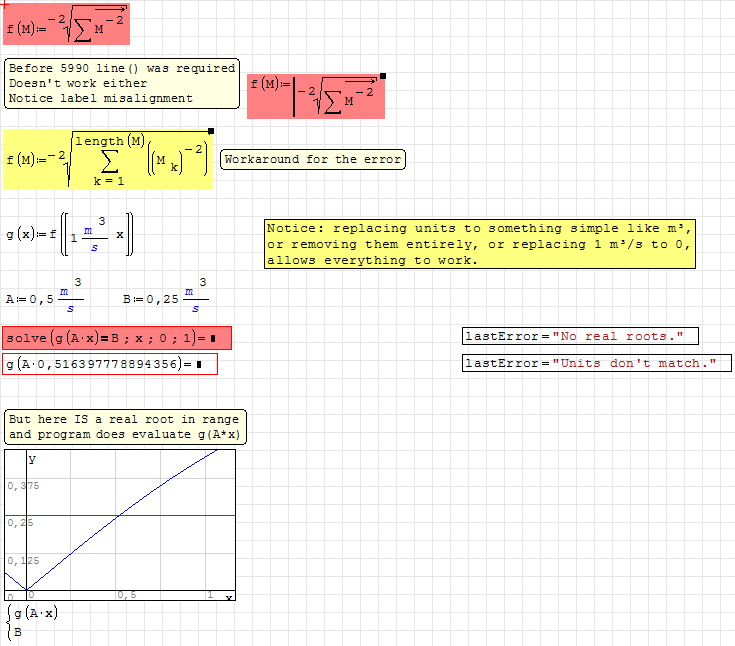

Mike Kaganski
Mike Kaganski
solvQerr.sm (9,17 КиБ) скачан 1797 раз(а).
С уважением, Михаил Каганский

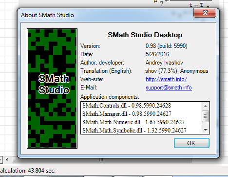

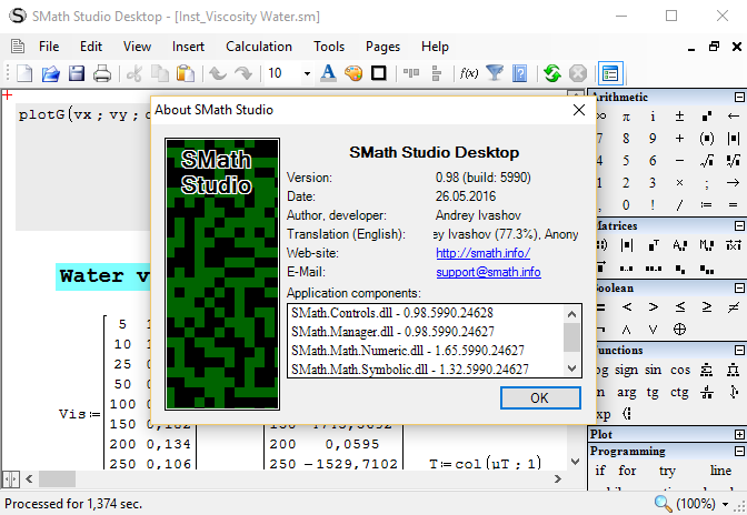

I found a bug in this version. Took over 5 minutes before I terminated the file. I took a snapshot with the timer running (shows 43 seconds) after Jean confirmed 5 seconds on his machine using version 5346.
Is this supposed to take over 5 minutes to calculate? May be SMath as this is the second sheet today that "locks-up" with the calculation tool bas and the timer running
Re-download in case something got wrong in the transmission.
XP Home, 1.8 GHz, Smath 5346 OFFicial release => 5 seconds
Inst_Viscosity Water.sm (52,14 КиБ) скачан 1934 раз(а).
Would be interesting more collabs test the timing, thanks.

Yes, but is this truly SMath bug? Or some extension's? Did you try to investigate before writing "I found a bug" to the New Smath Version advertisement topic?
I have no maple/maxima on my system, could that be a thing?

That was partial answer. I just upgraded to 5997 and there was an update to the Maple V wrapper. System went 14 seconds before I terminated it. I disabled the plugin and it took .98 rev 5997 0.760 seconds to process. Andrey fixed something in the new version as I was over 14 seconds with Maple disabled before. Sorry for not being clear before.
