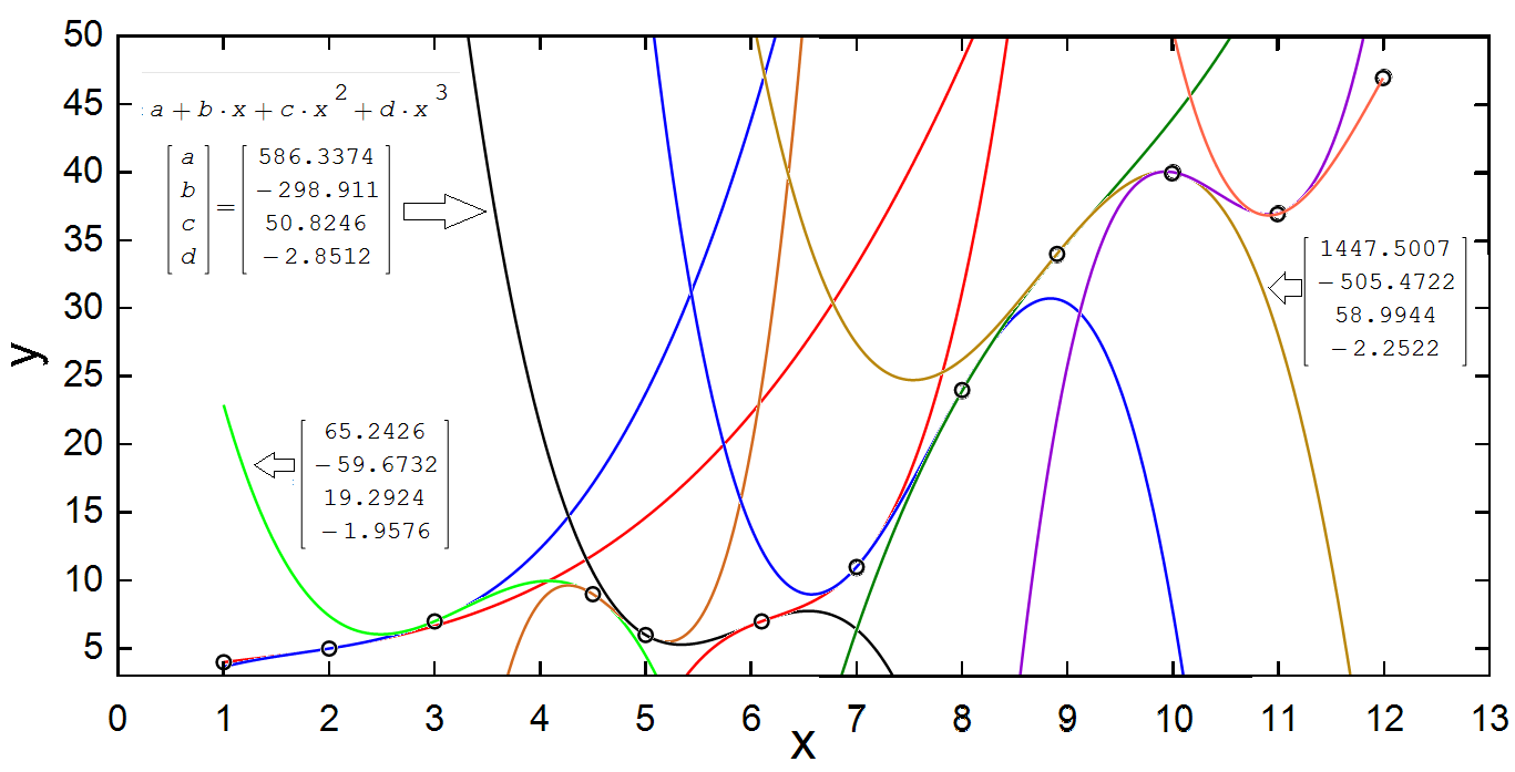

Hi Viacheslav. It seems that the Mathcad lspline actually it is a cubic spline. That as conclusion comparing lspline with the maple spline function. Thus, it has the Martin's restriction: x values must to be equally spaced (but that is not required for maple algorithms). Actually, that's looks like the best option for working with ODE's, especially for boundary conditions about the derivative of the spline function.
Maple spline function.sm (23.01 KiB) downloaded 1499 time(s).

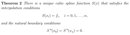

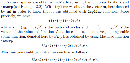

I will remind you of this document, which describes how the functions work. My implementation of interpolation has an error, but the coefficients themselves seem to be calculated correctly.
In Mathcad the first three numbers encode the type of spline. Jean doesn't know about this.
Cubic spline interpolation using Mathcad (2009).pdf (256.71 KiB) downloaded 2762 time(s).

Hi Viacheslav.
Yes, my comment is about that the lspline and pspline names could be sort of confusing, because, as the report says, mathcad's lspline, pspline and cspline are all "cubic splines". The "l" in "lspline" is not for linear interpolation, but for linear ends conditions, also called natural conditions. The "p" is for parabolic, and the "c" for cubic, all meaning ends conditions too.
Thus, Mathcad lspline is not related with SMath linterp or maple spline(X,Y,x,linear)
As usual. Yes, I know. You can also find here an adaptive spline interpolation using that encoding.
Well tutored Alvaro.
Easy to explore more from late Samples.
l & p have most remarkable effect in the start region.
Under the hood, l_spline is the interpolator ODEsolve.
