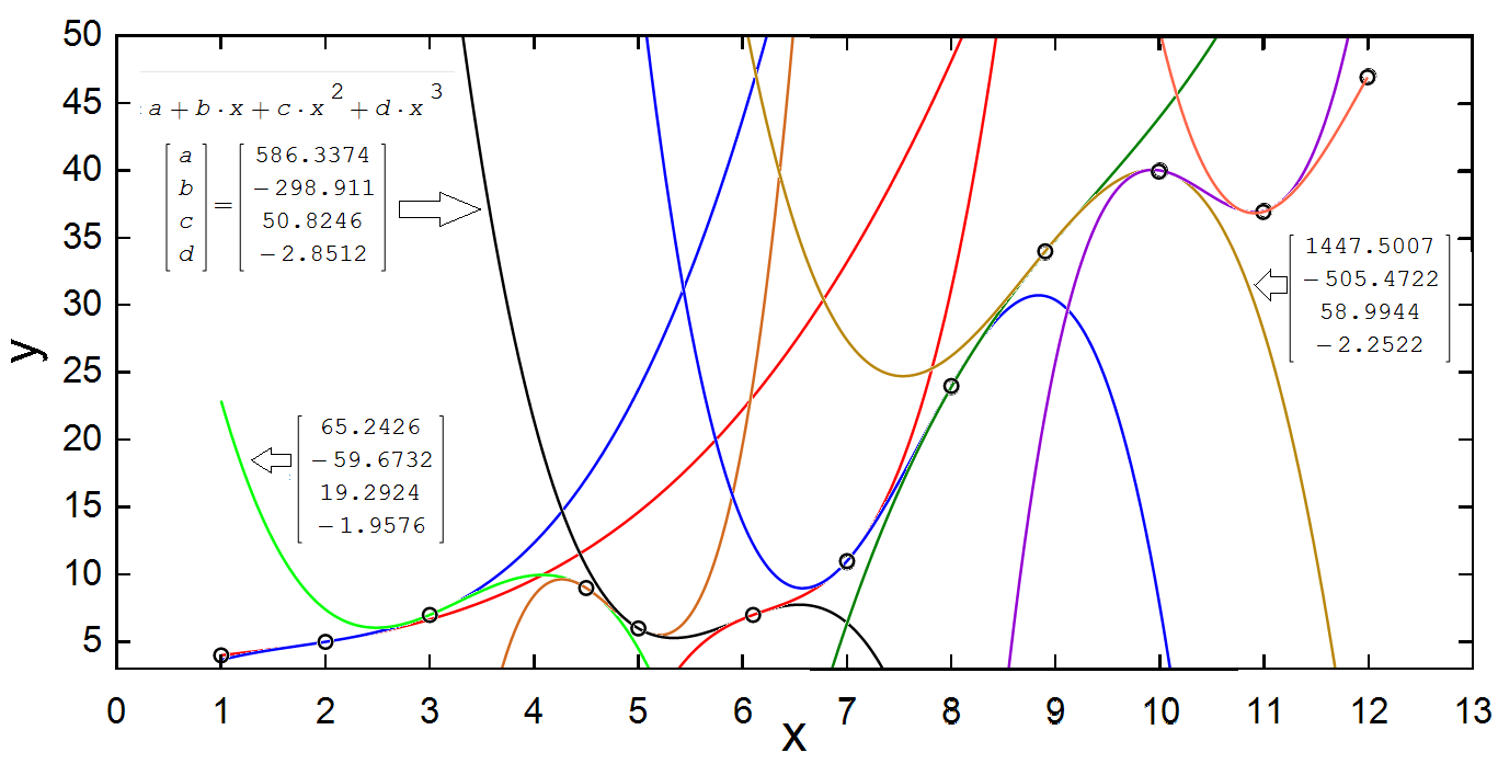

As a temporary solution:
Click to enlarge
linterp-xyplot-using-defined-argument.sm (21,7 КиБ) скачан 1548 раз(а).
interp(), ... functions from Mathcad Toolbox still have a bug. The implementation used does incorrect interpolation on some intervals. I don't know how to fix this yet, because the algorithm was restored according to the article and perhaps it was done incorrectly.

#3 Опубликовано: 11.12.2023 18:49:37
Valery Ochkov
Valery Ochkov
Благодарствую!
And what is it?
See the 3-d plot in attach without this bug!linterp.sm (21,44 КиБ) скачан 1512 раз(а).
#4 Опубликовано: 11.12.2023 19:25:45
Это и есть баг в численном алгоритме. К сожалению, требуется основательная переработка алгоритма для выяснения причины такого поведения. Я не силён в кубических сплайнах, в их реализации.
Эта проблема также ведёт к неправильной интерполяции в решателях ОДУ, которые кроме табличного решения предлагают и интерполированные функции. Там используется интерполятор из Mathcad Toolbox.
После реализации этих функций я делал только примитивные тесты и ошибка не была вовремя обнаружена.
Valery Ochkov 11.12.2023 23:17:00

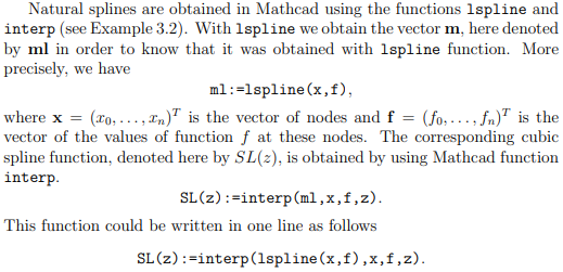

It seems that the Mathcad lspline actually it is a cubic spline.
I will remind you of this document, which describes how the functions work. My implementation of interpolation has an error, but the coefficients themselves seem to be calculated correctly.
In Mathcad the first three numbers encode the type of spline. Jean doesn't know about this.
Cubic spline interpolation using Mathcad (2009).pdf (256,71 КиБ) скачан 2762 раз(а).

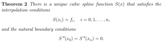

Hi Viacheslav.
Yes, my comment is about that the lspline and pspline names could be sort of confusing, because, as the report says, mathcad's lspline, pspline and cspline are all "cubic splines". The "l" in "lspline" is not for linear interpolation, but for linear ends conditions, also called natural conditions. The "p" is for parabolic, and the "c" for cubic, all meaning ends conditions too.
Thus, Mathcad lspline is not related with SMath linterp or maple spline(X,Y,x,linear)
As usual. Yes, I know. You can also find here an adaptive spline interpolation using that encoding.
