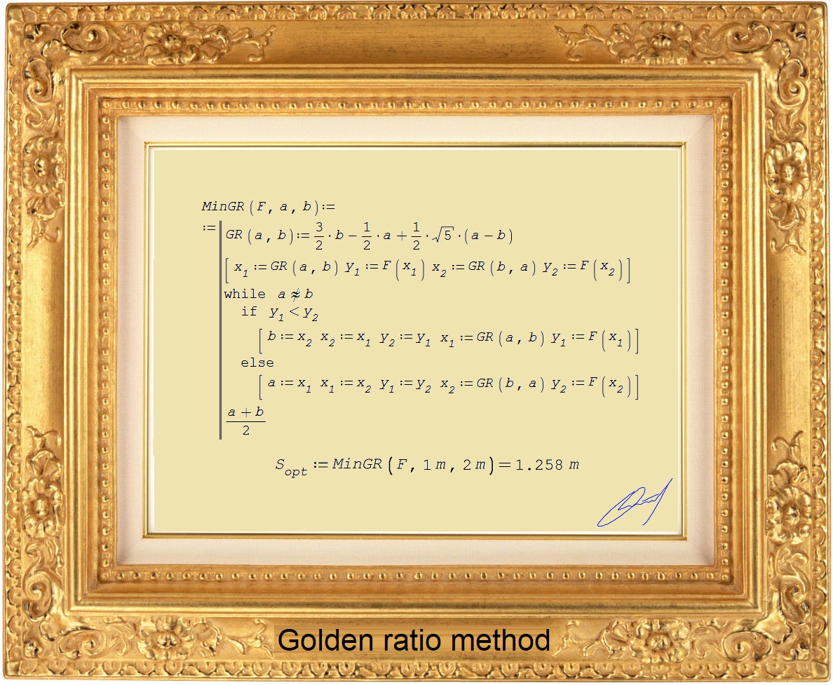

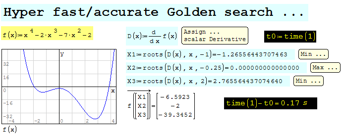

SMath Forum SMath Studio Samples Golden Ratio Method 1 Pages (3 items) Golden Ratio Method - for y(x) minimize - Messages Go to last post #1 Posted: 5/3/2023 3:08:07 AM Valery Ochkov 67 likes in 711 posts. Group: User 3-MinGR.sm (8.97 KiB) downloaded 1562 time(s). #2 Posted: 5/3/2023 8:15:21 AM Jean Giraud 983 likes in 6,866 posts. Group: User No need for approximately = ... decrease TOL as needed.Lot more in there: roots, discrete Golden, Dichotomy ... Cheers ... JeanGolden ratio QUICK.sm (130.08 KiB) downloaded 1526 time(s). #3 Posted: 5/3/2023 9:43:06 AM Jean Giraud 983 likes in 6,866 posts. Group: User ... if your function is not symbolic differentiable for 'roots':spline(s), all Smath based built-in ... Instead of 'roots' use solve(4) 1 Pages (3 items) New Posts No New Posts
