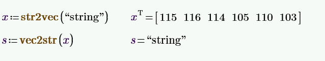

Is there a method within SMath for converting between strings and vectors of Unicode Points (or ASCII codes)? That is, a means of accomplishing what Mathcad's str2vec and vec2str do?

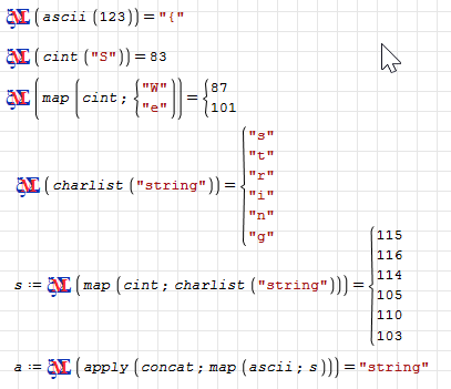

You can use Maxima.
string.sm (5.5 KiB) downloaded 1185 time(s).

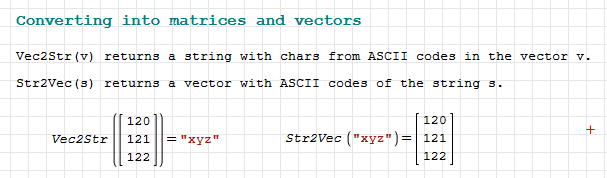

Hi Stuart. Nice to read you. You can use the functions in this post: https://smath.com/en-US/forum/topic/bppdgC/String-utilities, which, while not very efficient, at least get the job done.
