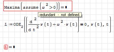

I'am not able to use the assume function.
Currently Maxima 5.42.2 is used.
I would appreciate any ideas
Thanks,
Lorenz

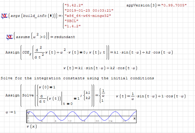

Can't reproduce.
You might want to use symbolic evaluation for the assume call.

#4 Posted: 4/5/2019 4:09:37 AM
1,138 likes in 1,805 posts.
Also, can work with complexes ...
MaxODE.2.sm (17.68 KiB) downloaded 1125 time(s).
#5 Posted: 4/5/2019 4:15:27 AM
Lorenz Grimm
Lorenz Grimm
0 likes in 4 posts.
Hi Everybody,
thanks a lot.....I forgot to evaluate symbolically the assume command....
