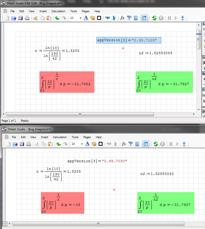

I have a simple integral calculation which contains a varable "n". If this variable is calculated in an earlier step, a wrong result is returned; the same calculation with a defined value for the variable (called "n2" in the example), the correct result appears. SMath Studio version 0.99, build 7030.

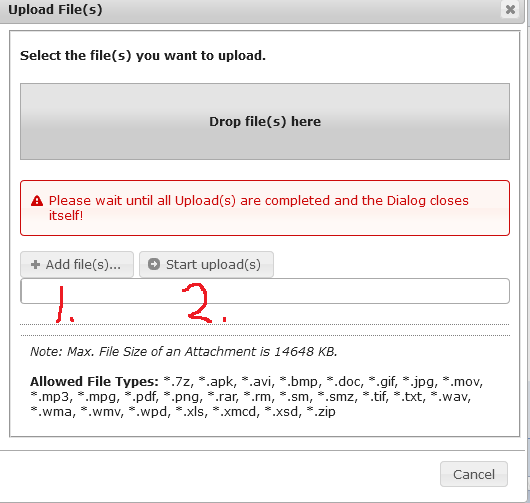

Is there a possibility to upload my sample file?
Sorry I missed this. To upload start writing a comment, click the following button....
then click add file first. Navigate to file and select. Then you must click start upload to upload it.

Are you concerned with the fractional result on the red?
If so right click on that section and change optimization to numeric. You'll get a numeric result.
#7 Posted: 7/23/2019 10:16:05 AM
Stefan Weisskircher
Stefan Weisskircher
0 likes in 7 posts.
Doesn't help, I still get "-18" in the left section (which isn't correct IMHO and still deiffers from the result on the right side (green))
#8 Posted: 7/23/2019 10:20:00 AM
Arie
Arie
94 likes in 285 posts.
Ok I just tried this in 7030 (latest stable) and can confirm I get the same results as you. This looks like a bug.
when I performed the same calculation in the newest beta version, the results seem correct.

Always plot the integrand for reluctant region.
Doctored SS 6179 ... seemingly same as SS7109
