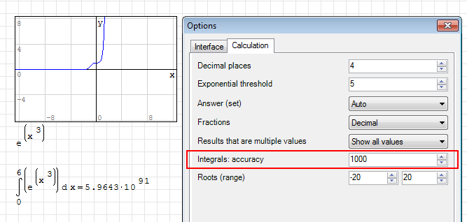

Integration of e(x^3) from 0 to 6 gives the following
1- sMath 7.4662*10^91
2- HP50G 5.964*10^91
3- TI 89 5.9639*10^91
4- PTC 5.964*10^91
What's wrong?
#2 Posted: 11/25/2015 7:18:55 PM
1,442 likes in 2,934 posts.
You have to increment the accuracy of the integration.
This option is available in: Tools > Options > Calculation
